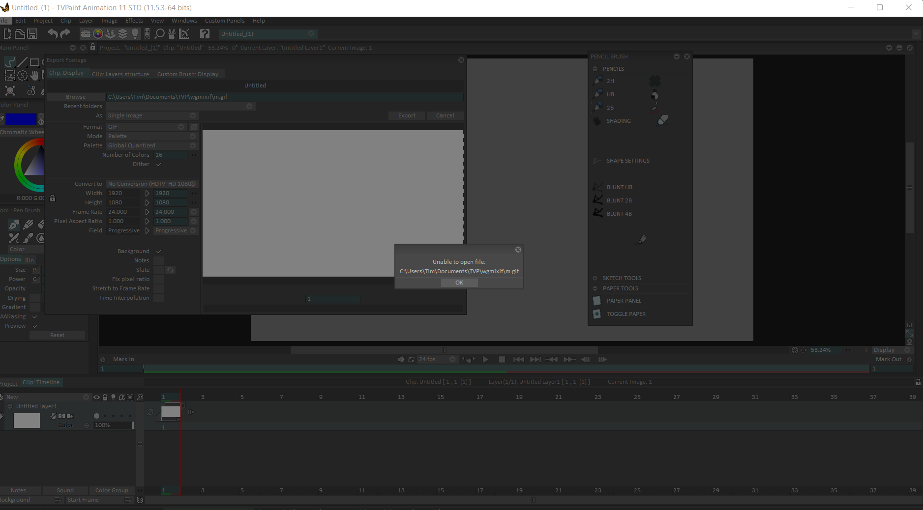

Hello. I'm having an issue where exporting is failing. I receive an error "unable to open file."

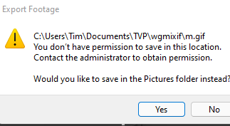

Furthermore, trying to save using the browse button, I receive a prompt saying I don't have permissions even though I'm running as admin.

Could you please try to create a simple text file, in the same folder ?

Yeah that works fine. I only have this issue within TV Paint.

Found that it was because Avast firewall was preventing TVP access to my folders. Thanks for your time.
