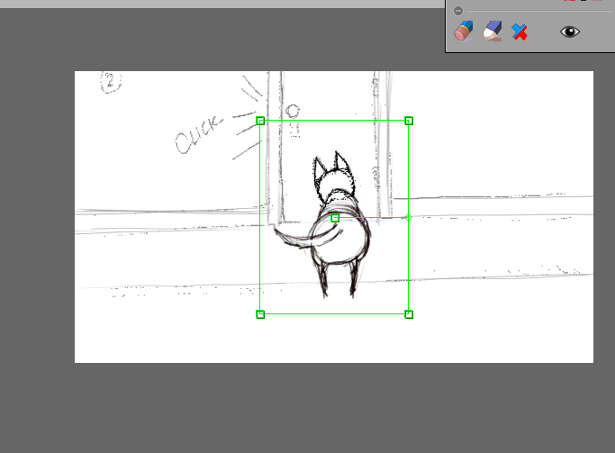

Hi all,
I searched before I posted, but I found nothing that addressed this specific, but hopefully trivial issue.
I have never used TVPaint camera, so I'm a camera noob.
I have an animated short set up for HD 1080p with a 150.00% ratio
I use Win 10 Pro and have TVPaint Pro (latest edition).
When I turned on the camera, the view shows vertical. But I don't want it vertical; I want it horizontal.
So, I opened some other projects with the same settings above, and the camera view is horizontal.
So, what could be different in this project than the others to cause my camera box to be vertical rather than horizontal? Where do I look and what do I do to fix it?

Camera View Vertical
- TVPaint camera issue.png (46.84 KiB) Viewed 5667 times

What happens if you click the camera tool > Parameters and change the dimensions there?

Re: Camera View Vertical
Per default the camera uses the resolution of the project you use it in. So was the project at some point vertical perhaps?
Anyway, you can change it by going to the parameters panel which you can open from the Tool:Camera panel
when you uncheck the Preserve Proportion option you can set it to your desired size.
Thanks to you both slowtiger and Peter Wassink. Will do.
