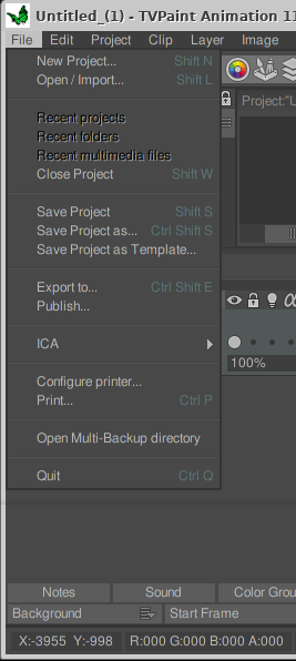

Just did it. We have little feedbacks regarding the recent file menu, so I will avoid publish a hotfix right now.
Capture d’écran_2021-10-20_16-25-29.png (42.31 KiB) Viewed 14411 times

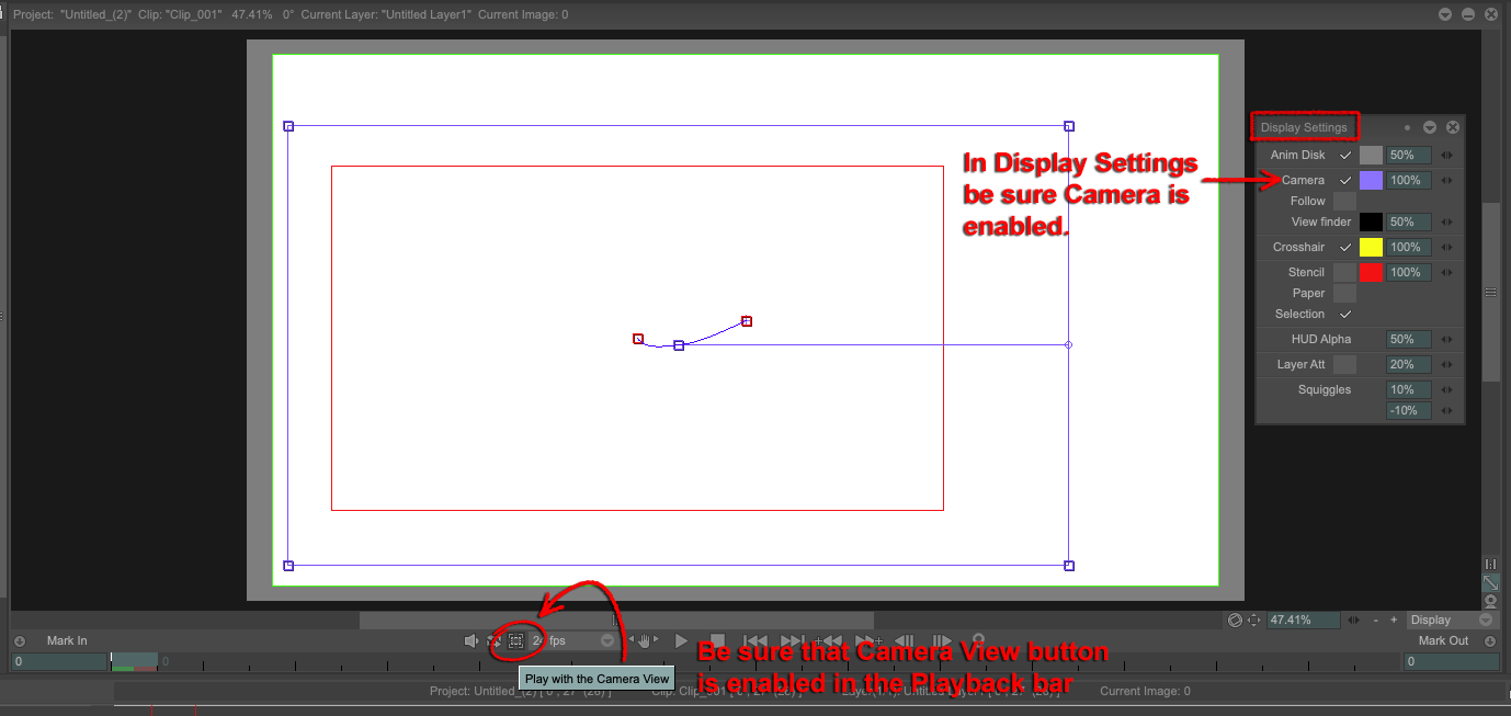

JoeMurray wrote: 07 Jan 2023, 13:54 A very simple move that I do with the camera icon but is not playing back with the move,
If the camera move doesn't play back, make sure that the Camera View button on the playback bar is active. Also, that the Camera View is activated in Display Settings (look under Windows > Show > Display Settings)

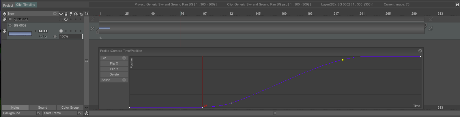

JoeMurray wrote: 07 Jan 2023, 13:54 or it chooses the whole movie for the move. I mark in and out, but that doesn't help. What am I doing wrong, or not doing?
If you want the Camera Move contained to only a portion of the scene, use the Time Profile (double-click on it to activate it).
Time Profile can be set to Linear, Spline, or Polynomial mode. I almost always have it set to Spline mode.
TVPaint Camera Profile Spline Mode.png (11.85 KiB) Viewed 9502 times
I will usually stretch out the Time Profile so it covers the entire timeline as shown in the screen capture below. In this case the camera is holding still from frame 1 until frame 76, then the camera move eases-in to the move and at the end of the move eases-out, coming to a hold at frame 241 and holds to the end of the scene at frame 300. (the redline shows which frame you are on , allowing for precise adjustment of the stop and start positions.)
Start position at frame 1 - to - 76
Camera holds until frame 76 then eases-in.png (58.36 KiB) Viewed 9505 times
End position at frame 241 - to - 300
Camera Move eases-out and stops at 241.png (55.31 KiB) Viewed 9505 times

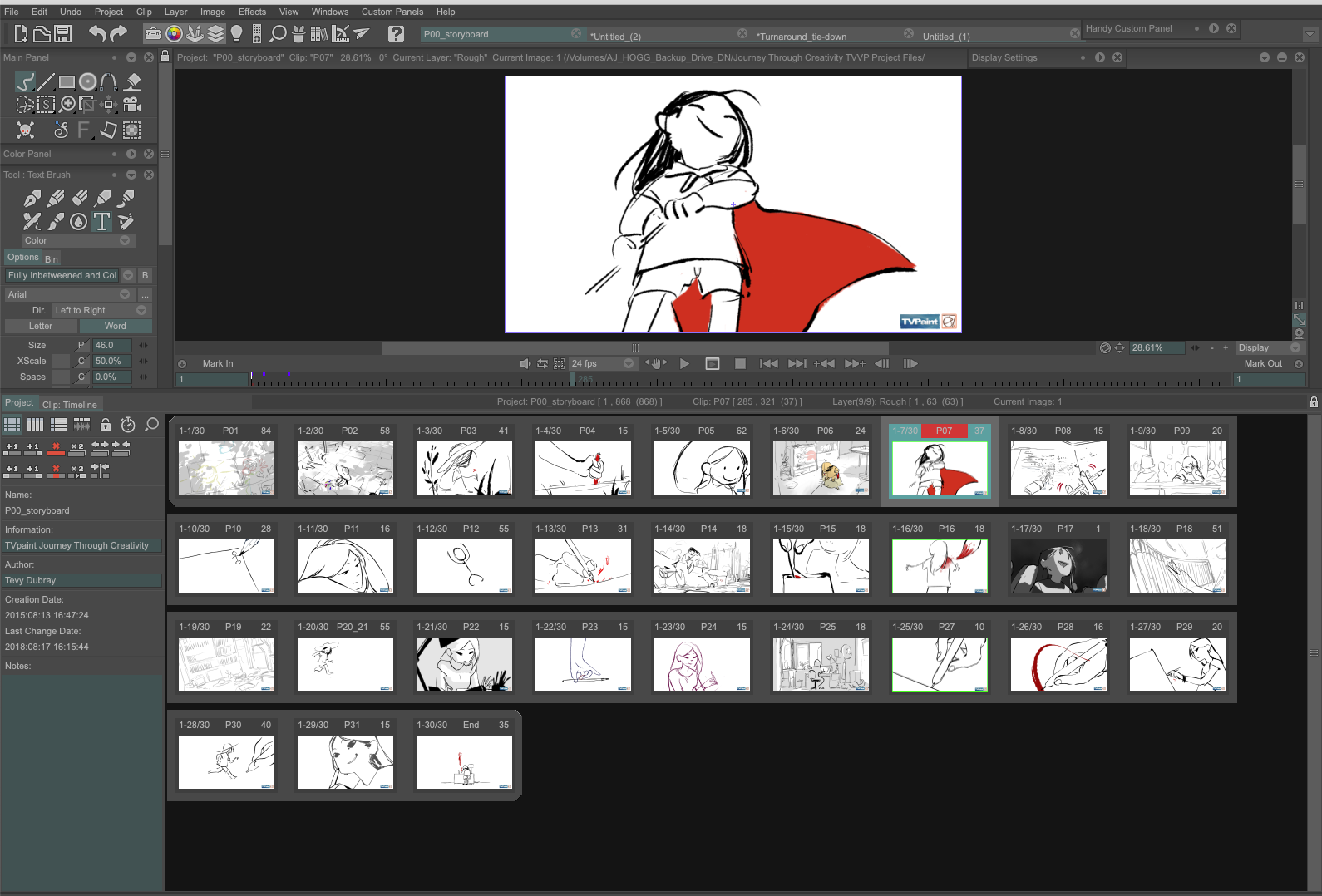

Ok, let's say you're starting with a storyboard/animatic of your 11-minute project. For sake of example I'm going to say there are 45 Scenes (shots) in your project. All 45 Scenes should not share a single timeline. Instead , split them up so each Scene is it's own Clip (TVPaint uses the term "Clip" for what I would usually call a Scene or a Shot). That way your camera move applied to Scene (Clip) 3 will only apply to that scene , not to any of the others. Each Clip in the project can have it's own camera move or no camera move, depending on what you want.
Screen Shot 2023-01-07 at 10.14.52 AM.png (95.19 KiB) Viewed 9485 times
See the section in the User Guide - Lesson 8 Create and Manage a Storyboard. https://www.tvpaint.com/doc/tvp11/index ... definition

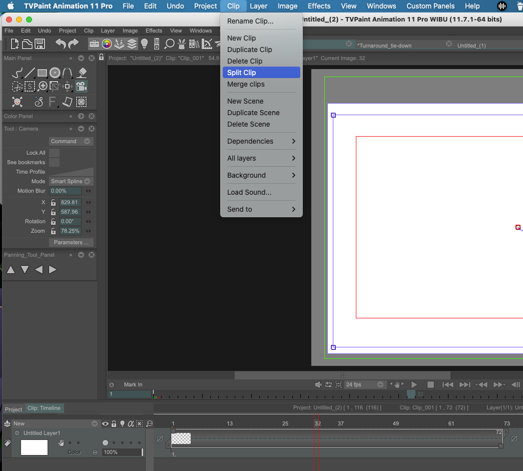

If you've already created a storyboard/animatic that has ALL the scenes sharing a single Timeline in one Clip , then you can use the SPLIT CLIP function in the Clip Menu to split them up into the required number of individual Clips (Scenes). In this example , let's say I already have a scene that I want to split into two scenes (clips) at frame 32. I put the cursor at frame 32 and go to Clip Menu and choose Split Clip. This will result in the clip now being two new clips . NOTE: most of the time you would want to Split the clips before you add any camera moves, because splitting the clip will disrupt the camera move if you've already added one. It's fixable after you've split the clips, but it can be a little tedious to retime the camera moves. So as a rule , if you have a storyboard for an entire project that has all the scenes sharing a single timeline , split it up into individual Clips (scenes) before applying any camera moves.
(click the image to view it full size)
