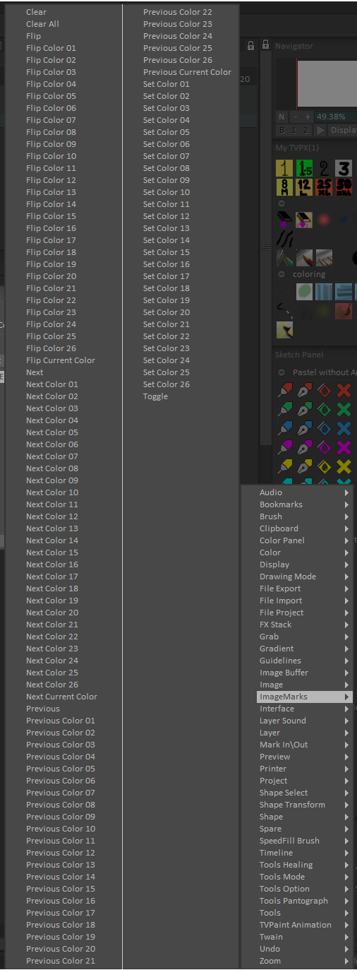

Currently we only have a single image mark toggle.
should not every mark color have its toggle?
i would like that, because it would make a markers-custompanel much more easy to use (and make!)
