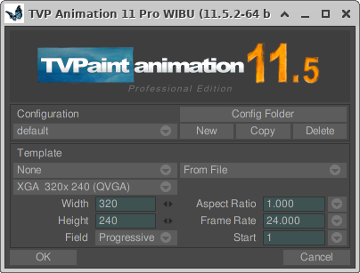

But there is also a plan B: using the startup panel. To do so, in TVPaint go to Preferences > Startup and then change the "Startup Configuration" to "Open Startup Panel" :
Capture d’écran_2021-09-23_11-32-50.png (11.37 KiB) Viewed 48484 times
The next time you start TVPaint, you'll see this window which lets you manage, create and duplicate configurations :
Capture d’écran_2021-09-23_11-35-06.png (50.47 KiB) Viewed 48484 times
