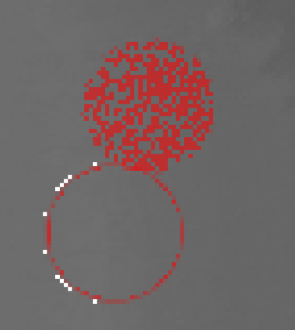

Ok, I made 3 rescales of my project, 2 downscales and 1 upscale : 8k to 4K UHD // 4K UHD to HD1080p // HD1080p to 4K UHD. The performance is quite different but I'm embarrassed to work in HD because I don't go back in 4K without losses.
Il could make my storyboard in HD thumbnails and enlarge them for began animation on them, but already I draw the layout with details in some clips.
Is there any tool in TvPaint of Detail Preserving Upscale ?
Exemples of rescaling :
8K to 4K.png[/attachment]
8K to 4K
8K to 4K
8K to 4K.png (48.51 KiB) Viewed 10740 times
HD to 4K
HD to 4K
HD to 4K.png (51.67 KiB) Viewed 10740 times
4K to HD
4K to HD
4K to HD.png (30.35 KiB) Viewed 10740 times

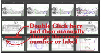

Mael wrote: 17 Sep 2021, 06:55 Do we have the possibility to change manually the clip numeration ?
Double click on the clip/scene title bar and manually change the scene number or label there.

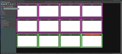

clip numérotation
clip numérotation
Capture d’écran 2021-09-22 à 21.38.27.png (33.94 KiB) Viewed 10197 times

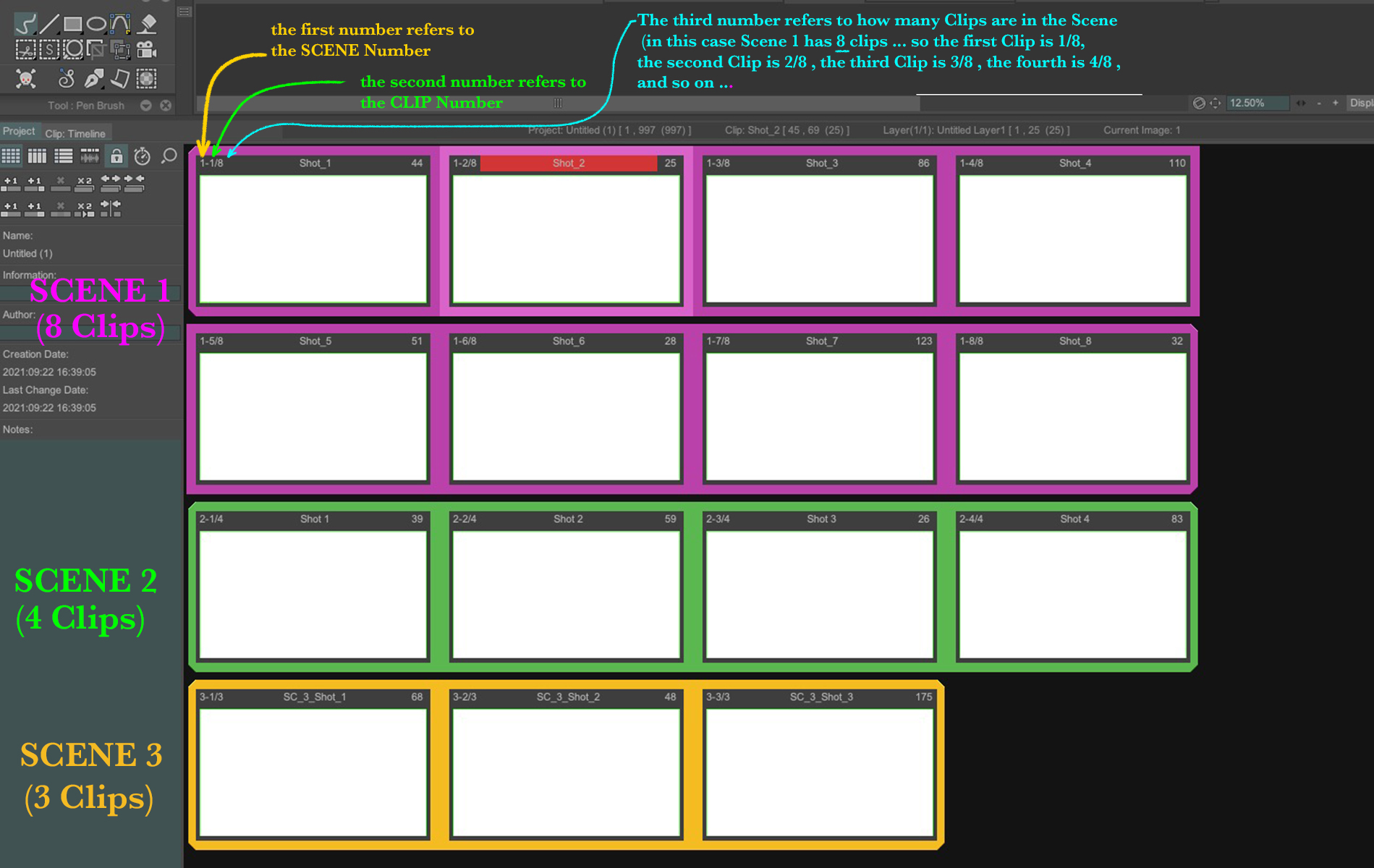

Posts: 4272
Re: clip numérotation
Mael wrote: 22 Sep 2021, 21:52And this one ?
That number in the upper left corner refers to SCENE Number (1) , then the CLIP Number (for example: 1/8 ... meaning 1 of 8 clips , or however many clips you have in your SCENE. That number in the upper left corner will update to however many CLIPS/SHOTS you have included in a SCENE.
So for example , below I have two SCENES : SCENE 1 (pink color group) , and SCENE 2 (green color group). There are 8 CLIPS (or Shots) in SCENE 1 and 4 CLIPS (or Shots) in SCENE 2.
The number in the upper right corner of each CLIP is how many frames the clip runs.

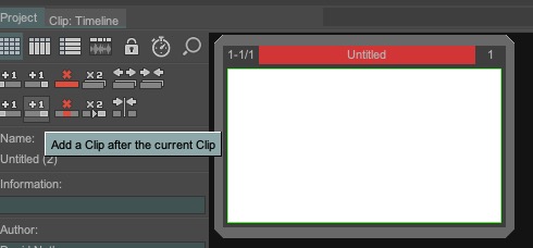

The buttons to the left have options of +1 SCENE (either before or after the current Scene) or +1 CLIP (before or after current Clip).
Screen Shot 2021-09-24 at 8.08.09 AM.jpg (70.38 KiB) Viewed 9990 times
Screen Shot 2021-09-24 at 8.08.17 AM.jpg (71.96 KiB) Viewed 9990 times
