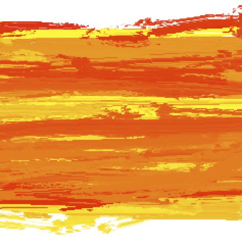

When I draw in TVPaint on my Wacom screen using pretty pure colours, they appear a bit muted and soft, as in this image which is a screen capture of a section of the TVPaint screen
This is TVPaint at 1:1 i.e. 100%
When I export that image, enlarge the .png so the drawing is the same size on the screen as the top image and do an screen capture of as close as I can get to the same area, the colours show as I would have expected them to show when in TVPaint - i.e. sharper /brighter / more intense / more pure / more saturated and as shown here

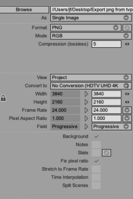

The settings used for the export were .

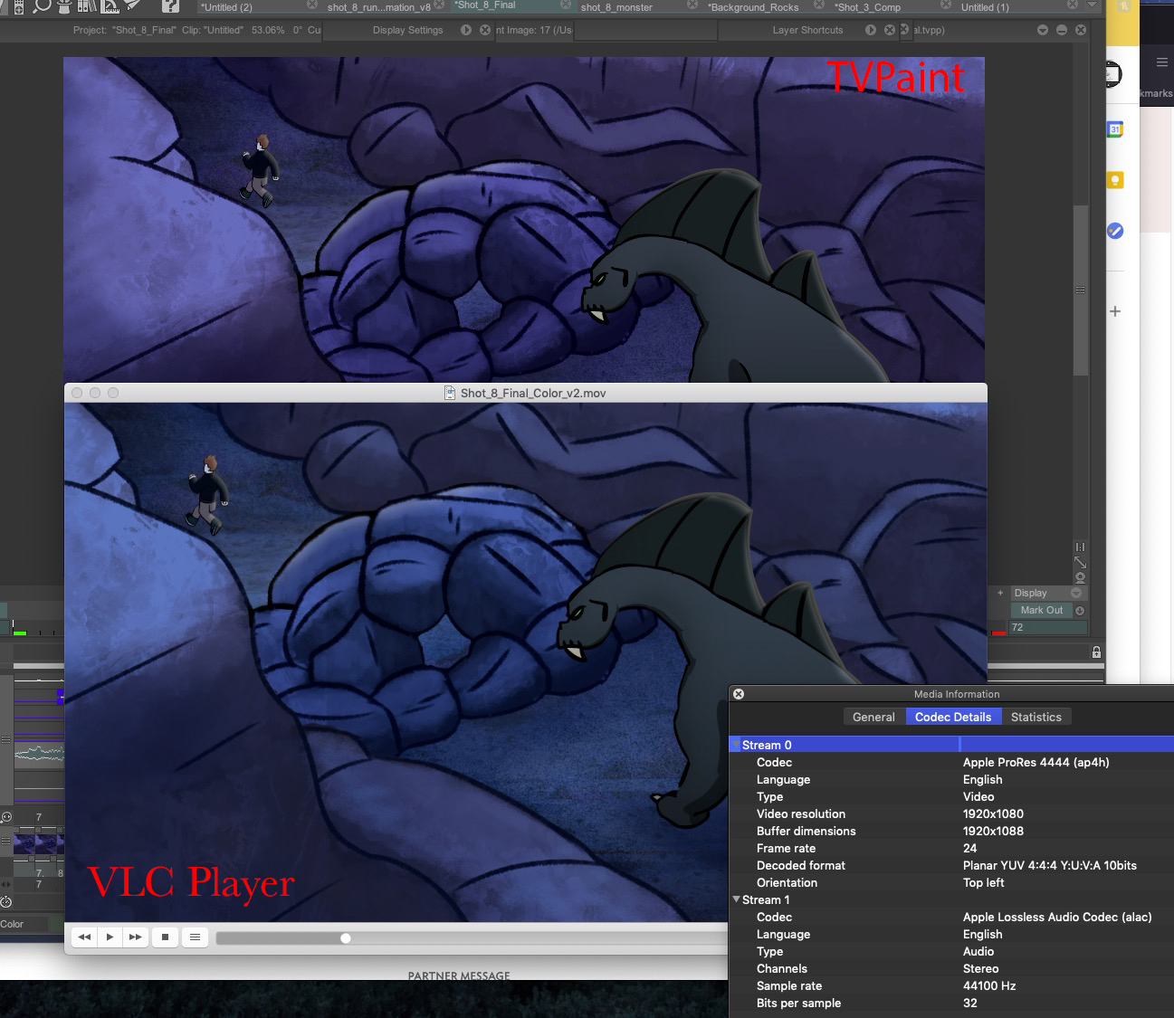

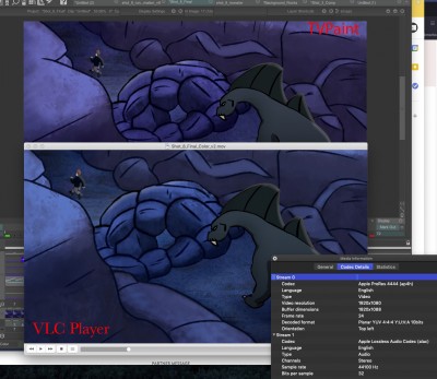

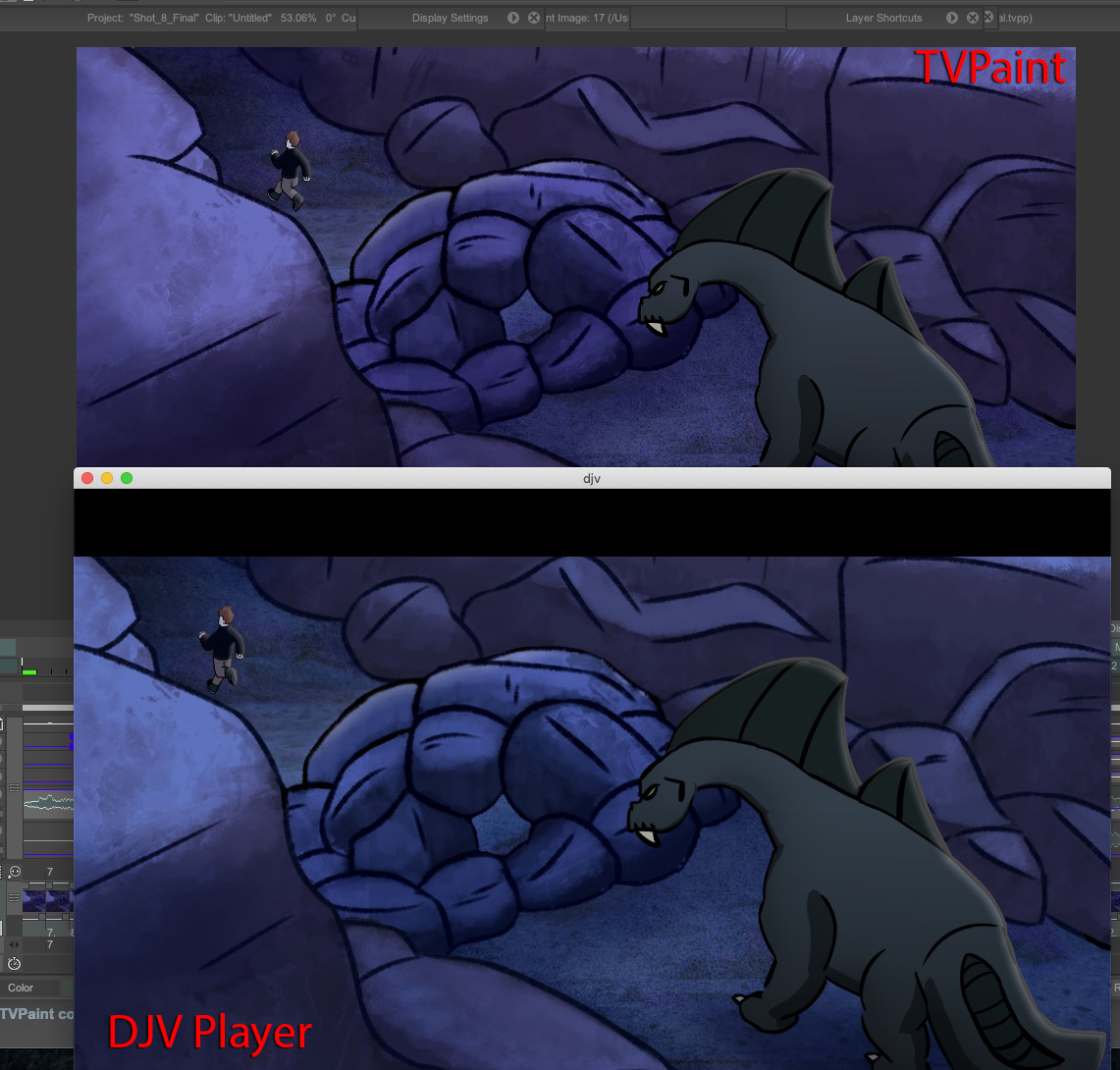

It is also a noticeable problem with how colours appear in TVPaint vs. how the colours appear when rendered to a .mov . (export to FFMpeg .MOV , with ProRes codec)
I'm working with a student right now on finishing her film and notice the difference in the colours in the TVPaint project compared to how the .mov looks played in VLC Player.
Almost the same results when using DJV Player .
The colours appear more accurate when played back in Quicktime Player 10.5 .
[click images to view larger]
There's a much more noticeable shift in the blues in VLC and DJV players than in Quicktime Player.

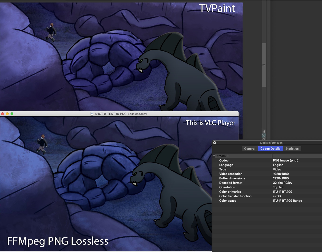

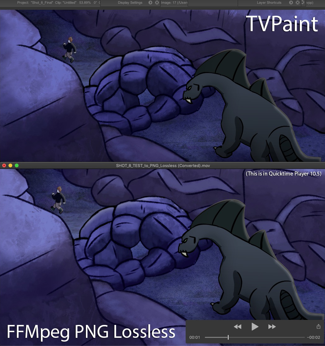

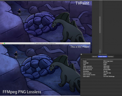

With the compression (ProRes) I think it's partially a problem with FFMpeg's version of ProRes codec causing the "torn/twisted/shredded" bits of colour in the compressed video because I used to get much more accurate colour when exporting to Quicktime > Apple ProRes 4444 (Millions of Colors) in the older 32bits TVPaint that could still use the Apple Quicktime codecs. Interestingly, FFMpeg's "ProRes" codec appears to render the colour accurately (compared to what is seen in TVPaint 11.5) when played in Quicktime Player 10.5 aka Quicktime Player X , but not in VLC Player or DJV Player .
Here are the results comparing colour fidelity between original TVPaint compared to FFMpeg PNG Lossless in Quicktime 10.5 and the same .mov file in VLC Player :
QUICKTIME PLAYER 10.5 - (in Quicktime Player 10.5 the .MOV file with PNG Lossless compression looks close to the original colours in TVPaint)
VLC PLAYER - (in VLC Player the blues have noticeably shifted when compared to the original colour as it appears in TVPaint)
