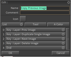

Posts: 1577
Re: Duplicating previous instance content in one click
This might do what you want...
Copy Prevous Image.png (31.29 KiB) Viewed 7468 times

Posts: 1577
Well, it sort of works, but I think only when the new frame is an exposure... I hope it serves to save you keystrokes.

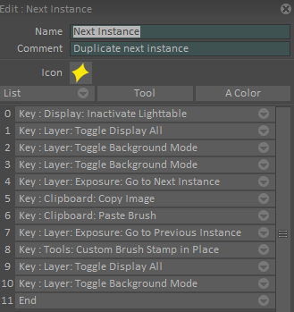

Hello, a small update on this. I've finally found a way to design the action how I want it to work! It's very hack-y and I don't believe I've covered everything that can happen, but it works as intended ! Just one click and you'll be able to transfer your next (or previous) drawing to the current instance. No need to fiddle with the small timeline squares or create unnecessary layers. Here's an overview of the script. (The script assume that you're working with the white background mode)
