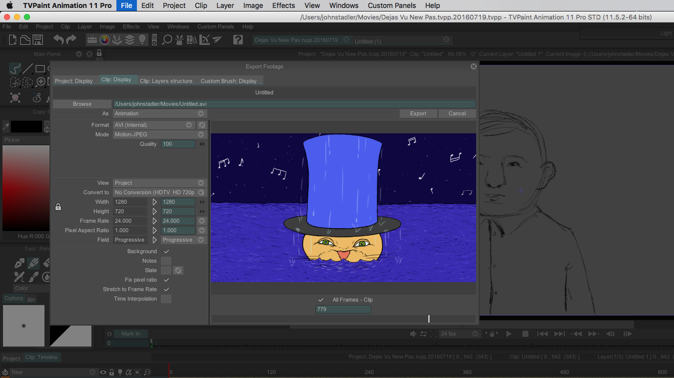

Greetings,
I recently updated to TVP 11.5.2 (Pro) 64 bit - {Mac OS High Sierra/10:13.6 - (w/Wacom Cintiq}
Tried to Export for the first time since then but can't seem to find the "Mark-in" or "Mark-out" options that used to be there in the Export Window. Please advise.
Thank you very much,
Johnny

Unchecking "All Frames" should return the original InOut selection.

Wonderful - thank you very much!
