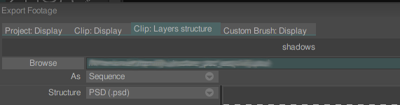

Trying to understand ... what do you mean by "layered psd frames" ? is it the "Clip: Layer structure" tab ? Do you export a clip structure as a sequence of psd files, like this ?
Capture d’écran_2021-08-11_15-45-01.png (20.01 KiB) Viewed 9265 times
Indeed the JSON format has this option to export only visible layers, whereas the PSD format hasn't the option. I'd need to discuss it with the team.

Yes, that's the tab I'm using. And I'm exporting the structure as psd files (like you have in your screengrab).
