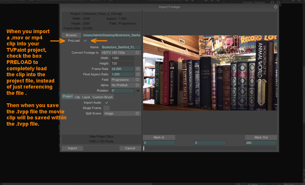

When you say you are "Importing a clip" do you mean that you're importing a .mov or .mp4 file into your project ?
I think the reason it may not save the file with the clip intact is because you need to check the box next to Preload when importing the clip. This will load the .mov or .mp4 file completely,
so it becomes an embedded element in the .tvpp file , instead of simply being a "referenced" file from outside the .tvpp project .
Re: Files don't save after importing clip
Hello, I agree with Mr Nethery, this sounds like a preload issue, please keep us updated
