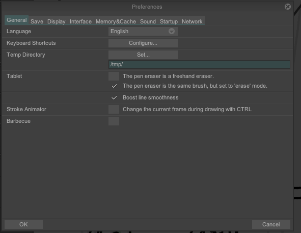

However: I don't see the options you are describing in the preferences.
I only see this
Screenshot 2021-07-09 at 13.47.21.png (30.6 KiB) Viewed 6439 times
And I can't change it in the Wacom settings, since I need the right click for a lot of things in TVP :)

Joost wrote: 09 Jul 2021, 12:24 Is there a way to disable the right click erase function?
But which action is configured in your driver settings for the right click ?
Otherwise, you can also uncheck both options in the preferences :
Capture d’écran_2021-07-09_14-29-47.png (5.01 KiB) Viewed 6418 times
