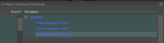

Posts: 4272
Re: Camera and Workspace Questions
SteamThief wrote: 19 Jul 2021, 18:37
slowtiger wrote: 13 Jun 2021, 10:25 If you press V, you get your clip in an extra window which has play controls at the bottom. There's a small button for "view with/without camera view". It's also in the Remote panel.
Nothing happens when I press "v." DO I need it to be set up that way?
The V key is set to something else in my keyboard shortcuts, too. For me it is shortcut M to create a new project window. I believe that in TVPaint 11.5 the default is M , so try pressing M to see if it opens a new project window (it will open full size , but you can click and drag on the corner to make the window smaller)
The other option is to us the Navigator Panel. To toggle the Navigator panel open and closed there is no default keyboard shortcut assigned. You can assign the command to Toggle Navigator Panel to whatever key you prefer.
Screen Shot 2021-07-26 at 8.51.44 AM.jpg (15.52 KiB) Viewed 11516 times
