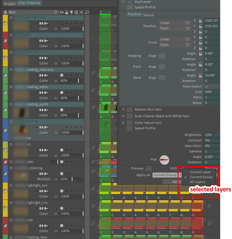

Currently to apply the FXstack one can choose between:
-current layer
-current group
-all layers
I would like to also have the option :
-selected layers
Because now if i need to apply on a selection of a pre-grouped selection of layers
i would either have to:
-do them layer by layer... or
-first change their group color to another single free group color and then apply the FX on 'current group' and then change all the layers back to their original group color.
both are no fun! :P

Some other nice to have options could be:
- active layers (FX only does the layers that are on)
- selected groups (This one would probably require a sub-menu in witch you can tick the boxes of the desired groups...)
but for now, i would need "-selected layers" the most.

Hi Peter,
you can try this short script which should do what you want (apply FX to selected layers).
It remembers your current layer and returns you there after applying the current FX to ALL THE FRAMES in the selected layers.
All the selected layers remain selected.
It will also let you undo the FX results with a single undo.
Copy the following script and insert it into a custom button's embedded GEORGE script window.

post details on any problem...
sven
EDIT: I should have warned that the script ASSUMES some FX process is already loaded into the FXStack and set to ALL INSTANCES. If not, it causes an error message "There are no FX in Stack!"

That looks like a great work around solution for us!
i'll check it out thanks Sven!
