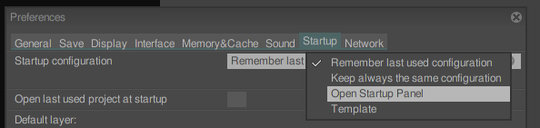

Open TVPaint preferences, then go to the Startup tab. Change the "startup configuration" to "open startup panel", then restart TVPaint.
Capture d’écran_2021-06-01_10-31-17.png (20.18 KiB) Viewed 13019 times

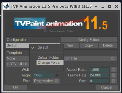

At startup you should have this tiny panel that lets you choose your config location :
Capture d’écran_2021-06-01_10-34-27.png (51.57 KiB) Viewed 13019 times

Xavier wrote: 01 Jun 2021, 10:40 Well that's how I assumed it should work ... but this panel doesn't seem very accurate.
What's not accurate about it?
In any case, this is what I see:
Screenshot 2021-06-01 092248.png (31.58 KiB) Viewed 12992 times
Is it a pro only feature?
David
TVPaint 11.7 Standard
System: 64GB RAM // 3 TB SSD // Core i7 8700K // NVIDIA GTX 1080// Windows 10 Home
Xavier
Posts: 1855
Joined: 01 Oct 2019, 11:08
Re: Is it possible to change location of config folder?
Post by Xavier »
spyderheart wrote: 01 Jun 2021, 15:28 Is it a pro only feature?
Yes you're right, sorry: I checked the code and it's available on pro versions only.
spyderheart wrote: 01 Jun 2021, 15:28 What's not accurate about it?
I mean that it doesn't seem to relocate your config folder anyway.
