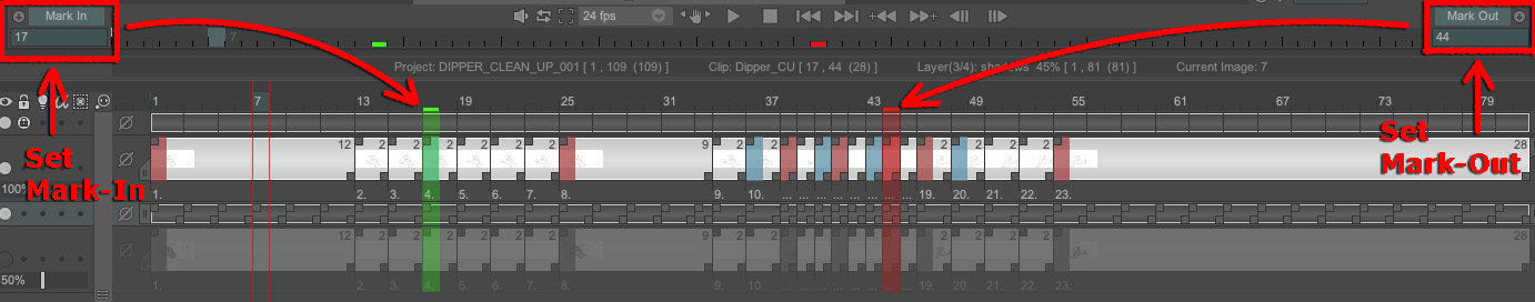

Set the Mark-In point where you want it to start playing at frame 157.
In the screenshot below it shows Mark-In point set at frame 17 and Mark-Out point set at frame 44.
This will only play from frame 17 to frame 44.
