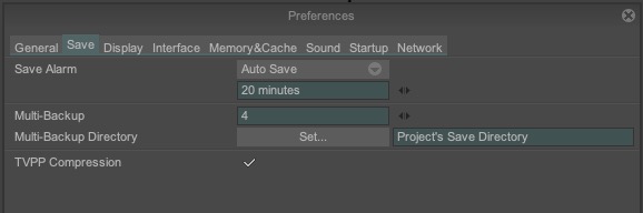

Here's a thought -- did you have the Auto-Save turned on in Preference to save multiple back-ups ? You might be able to go back to an earlier version of the file saved on your hard drive to recover at least some of your previous work in one of these saved versions.
If you have any saved versions they will have the main file name Veronika_Skrotskaya_all projects.tvpp , but then a string of numbers after the .tvpp extension , like this: Veronika_Skrotskaya_all projects.tvpp.20210422.180653 Just remove the string of numbers after .tvpp and the backed-up file should open in TVPaint. (after removing the string of numbers , you should change the file name to something like Veronika_Skrotskaya_all projects_v2.tvpp if you have the original Veronika_Skrotskaya_all projects.tvpp still sitting in the same file directory , so it doesn't get over-written.
