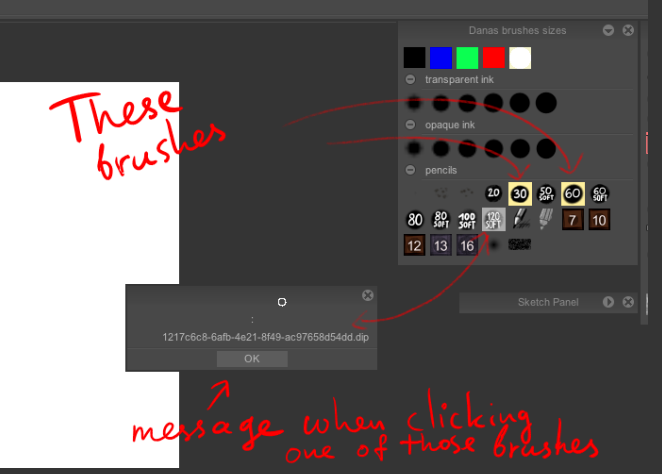

After installing TVP 11.5.1 and deleting the previous versions, a few custom brushes have stopped working and TVPaint is showing a weird message with no text (see screenshot).
I have checked the .dip file it shows, and I cannot find it in any of my previous Time Machine backups, which probably means that these custom brushes had a different name.
I am not sure if deleting previous TVP versions caused this, because all my config prefs stayed intact in the Library folder and also it only affected a few random brushes — the rest is fine...

Not sure here about what to say. First of all, this message box is definitely to improve ! at least put a message.
The custom brushes are saved as dip files in your cache folder. Do you find the file that is mentionned by the message box in your user library (~/Library/tvp*) ?
From a command line, you can run this :
Alternatively, try exporting the brushes from TVPaint 11.5.0 and then import them into TVPaint 11.5.1.
Weird, anyway.

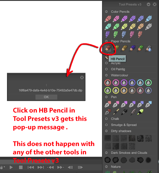

The HB pencil in Tool Presets v3 shows the icon still present , and the tool works, but every time I click on HB Pencil I get this odd pop-up message,
16f6a479-dafa-4e4d-b10e-75492a5e47db.dip - OK
Click OK and nothing happens ... but the tool still works to draw with. It's a strange thing that it only happens with that one tool in the Tool Presets v3 panel.
It seems to be saying something is missing (?). This started happening on the update to 11.5.1 , not before.
Fortunately, an easy fix. Delete Tool Presets v3 , then restart TVPaint and it regenerates the tool bar and now the HB pencil functions normally on selecting it , without the odd pop-up message appearing. But I thought perhaps this was related in some way to the problem Soom is experiencing, so I am reporting it.
