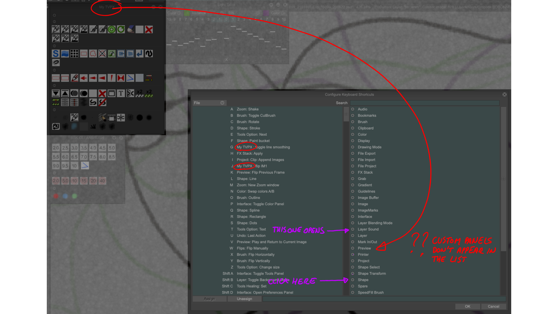

problems:
1. custom panels don't appear in the shortcut list, although already assigned shortcuts are still in the assigned list. Is there a new setting I don't know about to let them appear in the list? or is this a bug?
2. when I select an item in the list at the right, the item 8 lines above the one I selected opens. The amount of lines it misses is depending on how far I am in the list. The first item no problem, but the last item there's a shift of 9 lines. Same with Wacom pen or mouse. No problems in the left column. There it selects the selected item.

Just checking : did you get the 11.5.1 update posted on March 15, 2021 ? That should fix the issues with the Shortcuts list.

yes, as I wrote...I'm on 11.5.1
Posts: 4272
Re: issues with shortcut window in macOS
hilere wrote: 01 Apr 2021, 18:23 yes, as I wrote...I'm on 11.5.1
Sorry, I missed that in your first message . :oops: Skimming too fast. I jumped to the conclusion that you might not have updated to 11.5.1 yet. I had the problem in 11.5 , but it seems fixed in 11.5.1 . Sorry to know you are still having the problem.

PROBLEM SOLVED...and it had nothing to do with TVPaint!!!
After uninstalling and re-installing my Wacom driver the problem disappeared.
So if anyone has this problem...it's a WACOM PROBLEM.
