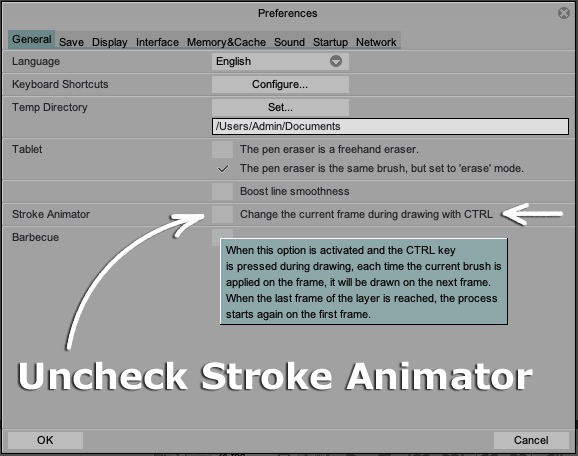

Title In Large wrote: 17 Mar 2021, 18:43 When Ctrl is held down, regardless of whether it's part of a shortcut string or Ctrl on its own, if you interact with the screen the timeline will begin to "animate the stroke" in real-time as you touch the tablet. This becomes a big problem with any hotkey share shares the Ctrl button input. Could there perhaps be a way to optionally disable this feature in the future to prevent destructively force-animating on my work?
Disable that function in the Preferences > General tab by unchecking the box next to Stroke Animator.

D.T. Nethery wrote: 17 Mar 2021, 18:57
Thank you very much, D.T! :D
