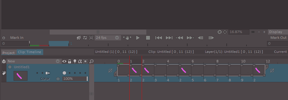

Is there a way to rename only the instances of the same name? I would like to rename all the potentially empty instances to '0'

tribute27 wrote: 04 Feb 2021, 22:14 Is there a way to rename only the instances of the same name? I would like to rename all the potentially empty instances to '0'
To rename a single instanced right-click on the selected instance . From the menu select Rename > Selected Instance.

Not quite what I was looking for but it's appreciated! I was thinking more of if I rename an instance, it would affect all other instances with the same name. The second link does eliminate a step of that process though, so much thanks!
