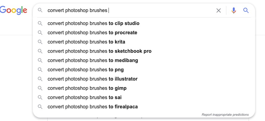

I noticed if I do a search for "Convert Photoshop Brushes to" I get results for Convert Photoshop Brushes Clip Studio, ProCreate, SAI , Krita, GIMP, Sketchbook, etc. , it seems that people are doing this for other apps.
Screen Shot 2021-01-21 at 12.29.02 PM.jpg (60.67 KiB) Viewed 26910 times

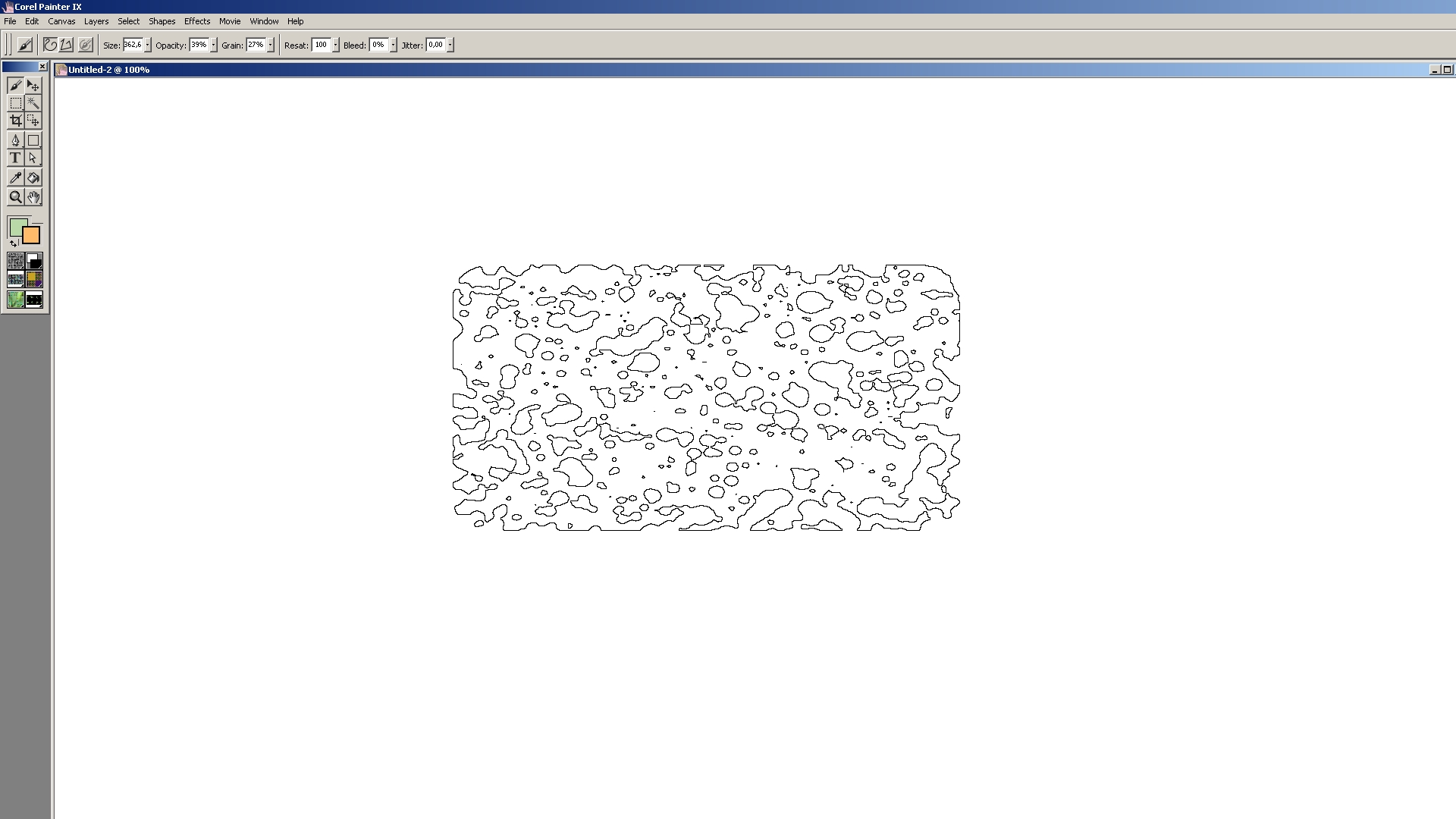

Digging around in the forum , there have been conversations about adapting Photoshop (or Corel Painter) brushes going back many years (to 2007). Here's one that discusses the basic procedure for recreating a brush:
viewtopic.php?f=11&t=1537
This was from Hisko Hulsing, regarding a brush he and Peter Wassink recreated in TVPaint (from Painter)-
this brush
"I made a screenshot of the Painter brush, and imported the image in TVPaint and added paper and pressure for the opacity.
I'm working with the brush right now and it feels even better than the one in Painter."

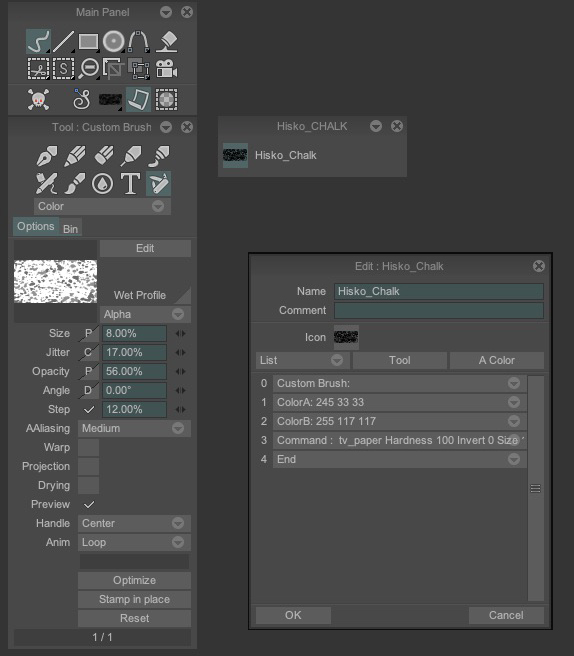

1. Select a brush in Painter or Photoshop.
2. Make a new document and zoom in until the form of the brush is big and clearly visible
3. Place your mouse or pen above the white canvas (or whatever)
4.make a screenshot (when you are still in Painter or Photoshop)
5. Open a document in TVPaint and than: Edit - Clipboard - Get brush from clipboard
(NOTE: in TVPaint 11/11.5 this will be Edit > Clipboard > Paste Image )
Screen Shot 2021-01-27 at 9.33.45 AM.jpg (32.13 KiB) Viewed 26750 times
6. place the brush by clicking on the canvas in TVPaint (if you use TVPaint 11.5 Edit > Clipboard > Paste Image
the brush image is already placed on the canvas at this point)
7. Turn the white pixels into transparent by: FX Stack > Color > Scan Cleaner B&W
8. fill the Brushform with black using the Paintbucket fill tool.
9. Use the Cut Brush tool to pick the shape up as a Custom Brush.
Screen Shot 2021-01-27 at 9.16.25 AM.jpg (50.2 KiB) Viewed 26754 times
10. Play around with the settings of the Custom Brush (this can include
adding paper).
11. We looked at the behaviour of the brush in Painter and decided to put the angle on D (direction) and a jitter of 17% (to give it a more fuzzy random look) and pressure for 56% opacity.
We didn't use the profile editors, but if you want you can also edit those with graphs.
12. Copy and Paste the Custom Brush to a new Custom Panel. "

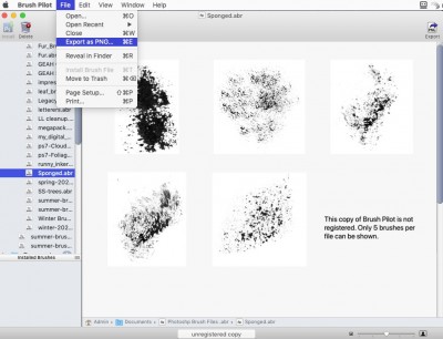

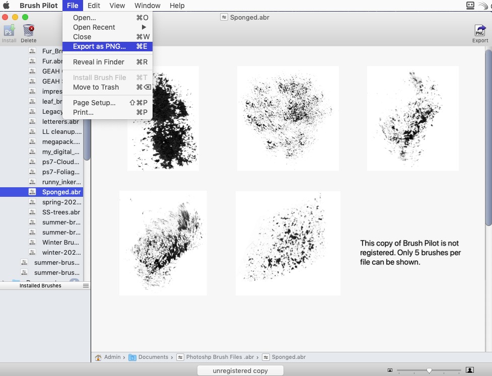

There was also Brush Pilot for Mac , which is no longer developed or supported. It works on Mac OS Mojave, but not on Catalina or BigSur .
I was able to download it from https://mac.majorgeeks.com/files/detail ... pilot.html , but unfortunately there is no way to register it .
The unregistered version can only display 5 .abr images at a time. It does allow for exporting the brush image to PNG.

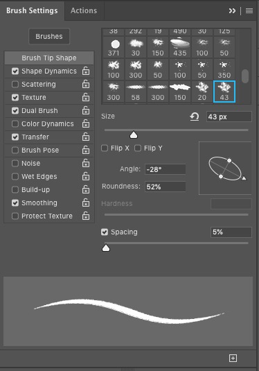

Can anyone tell me how to interpret the Photoshop brush parameters to match the brush parameters we have in TVPaint ?
What I mean is, what are the equivalent parameters for Photoshop's Shape Dynamics, Scattering , Texture , Dual Brush, Color Dynamics,
Transfer , Brush Pose, Noise , Wet Edges, Build-Up, Smoothing , Protect Texture ?
I understand that TVPaint may not have an exact equivalent brush parameter for each Photoshop brush parameter , but I'm wondering which of TVPaint's brush parameters
are more or less equivalent to the Brush Parameters listed in Photoshop ?
Just for one example: is "Spacing" in Photoshop the same thing as "Step" in TVPaint ?
Or how about "Angle" in Photoshop ... does that mean the same thing as "Angle" in TVPaint or is it more like "Orientation" in the TVPaint brush options ?
The question is: which of these various brush parameters in TVPaint are equivalent to the brush parameters
in Photoshop , even if they have different names ?
