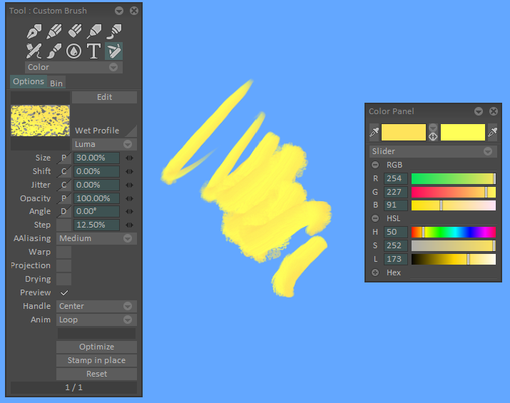

Re: Brush Creation Help
Thank you for the advise, I really like what the luma setting allows to do!
I just have a tiny problem, that switching from alpha stamp to luma, makes my brush very transparent. I don't really understand why tho... Any pointers? The brush I'm speaking about is this one. I'd really appreciate it, thank you!
