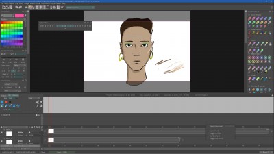

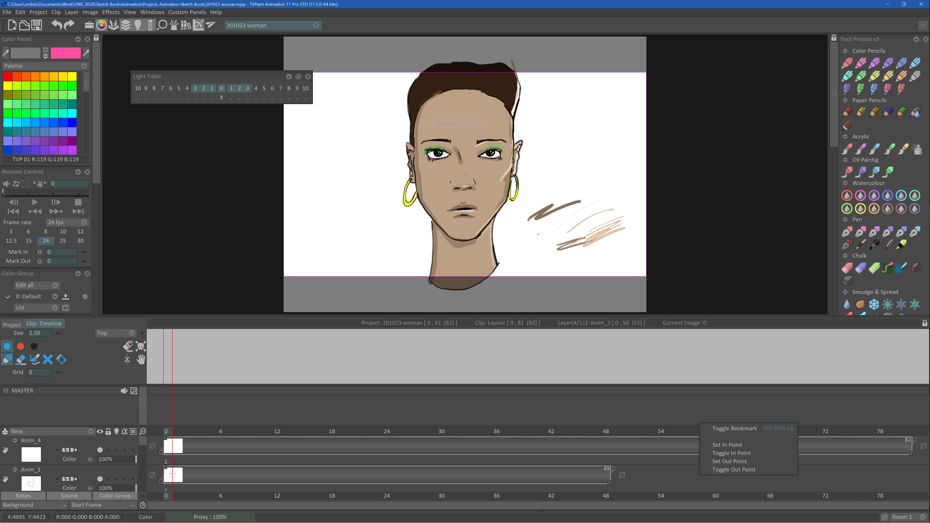

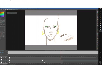

I thought I would post an example of what I mean.
vs
It's just the timeline which is a bugger for me at setting 1 the handles in particular are very tricky to grab with the wacom pen. I love the real estate for drawing and the icons are fine to grab and click at this size (at least for me) butI should also add that resizing windows at this res is also tricky. In Da Vinci Resolve (and others) you can resize the timeline tracks as you see fit. I use this all the time - very helpful.
vs

I had the same problem on a Cintiq Companion 2. 1 is too small and 2 is too big. Maybe it would be nice to introduce a 1.5 while TVPaint doesn't do proper scaling by itself
