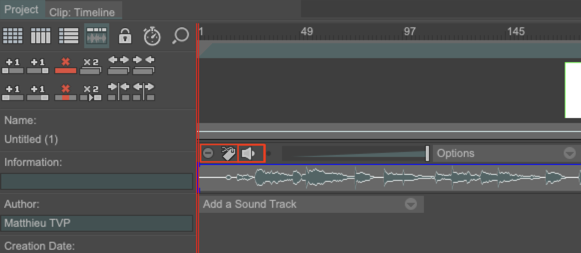

Could you please let me know how you're loading your sound track?
If you're loading it from the "Project > Load Sound..." menu then muting the Master track in Clip view won't do anything since the track was imported at Project level instead of Clip level.
If the sound track was imported at Project level you'll have to mute it by going there:
Capture d’écran 2021-08-09 à 14.22.04 2.png (45.41 KiB) Viewed 7534 times
