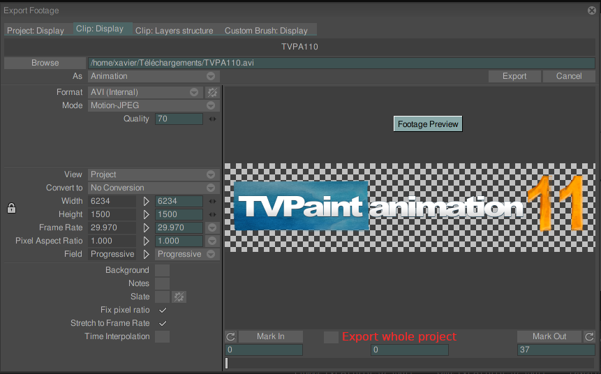

i found that if you select a range you can click on the circle arrow symbols next to the mark buttons in the export panel..
a bit unintuitive, i would think it should per default follow the mark in and out of the project, when set?

That was shot down by several users including myself. I'd hate to have to remember each time I export a project to turn off the markers. Also markers are often shifted around in the animation process and I like to find these where I last used them when I return to TVP. In the rare cases I would like to export less than the complete project I change the in and out frame numbers in the export panel.

Hi, could you please explain precisely what you'd like to have ?
From what I understood:
- by default, export the full project (no markin and markout)
- automatically set the markin and markout, based on the selected instances
What about a checkbox, that you'd have to untick to set the markin and markout ?

The check box sounds the most reasonable to me, if I understand the options properly. The way I understand this is that someone like me who doesn't like to have the mark in and out placements reflected in the export panel but on the rare occasions when I need to have them visible I would uncheck the box. Is that correct? And by the same token, anyone who wants their mark ins and outs reflected during export would keep their check box unchecked

yes, that's what I meant
