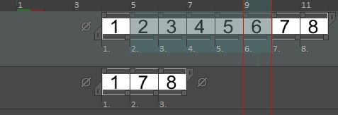

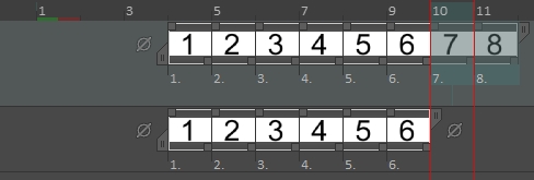

when I'm using tvpaint maybe version11.0.09...?
the function 'cut selection/cut Image' cut exposure or instance, with moving behind of cutting parts to front,
but in 11.5
'cut selection' cut exposure, with moving front side of cutting parts to backward,
Is it intentional change?
but in 11.5

Ah, sorry, i get it. Thanks for the pictures !
It is related to the 'delete selection from layer' that you can find in the right click menu from the timeline.
I think you can associate the key to another function 'fill gap from right'.

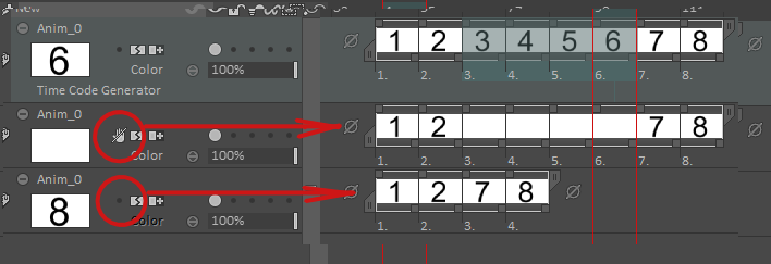

Re: cut selection in 11.5
i agree this request was not implemented perfectly
this was my original request:
see image:
so this was partly implemented, but unfortunately we lost this...(also from my request post):...
My request is that when a selection of frames on a layer includes the first frame, deleting this selection, should leave the remaining frames at the position that they were
In by far the most cases i delete the first part of a layer to trim it to match other layers, meaning the rest of the layer should stay put.
Now, after deleting
begin frames, i always have to re-shift the remains back to where they were before.
the general logic in layer behaviour when deleting frames should be:
deleting frames lets the layer stay in position on the timeline
it would help if users can set what the "DEL" button does:When you are anywhere on the tail of a layer and you delete a selection of frames (or just one), the layer remains at its start position and the frames after the selection are shifted to the left.
so far so good.
see image:

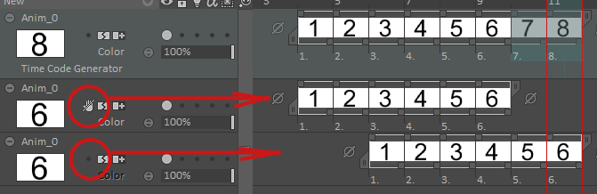

No worries... release of 11.5 came a bitsuddenly, i feel this layer behaviour is very important for teh workflow of any animator so it deserves some carefull attention.
my idea at the time of the request was simply this:
when you delete a frame or framesequence that contains the first frame of a layer let the rest of the layer stay put
if you delete a frame or framesequence that contains the last frame of a layer, those will just be cut off
when you delete frames in the middle the first frame will not move. but here your delete options would come in handy maybe you can use the lock position toggle to have an influence on these actions?
so the first case happens when lock position is on.
but when lock position is switched off it would behave in the old way?
- Posts: 4502
how this idea could work in the other cases
deleting the tail
deleting from middle
deleting the tail
