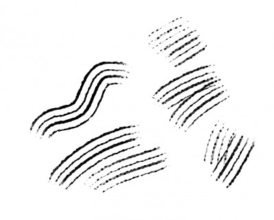

I try to create a kind of crosshatching brush but can't get it right.
I want it to look like in the attached image. It's created in Clip studio paint.
Thanks for all help I can get.

Your example shows lines in parallel as created by a rastrum: that special 5-pointed pen for drawing staff lines for musical notation. It's possible to do, rotation commanded by direction, but you will experience chaotic behaviour at beginning of some strokes.
Cross hatching is done by short parallel and straight lines, in several layers and different directions. Since it's only used to fill areas I can simply create a bunch of stroke bundles and have their orientation set at random.

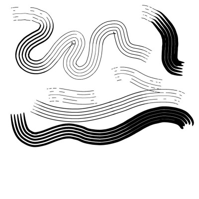

-thank you for quick answer.
I managed to create a brush that works.
