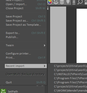

hmm... when I open TVPaint, there is not even such a thing "Recent Export" - I can only see "Recent Import"... (see screenshot) and the last saved file is not there.
Generally speaking I find it very confusing - I would expect a simple list of recent files under the Open menu, which is the standard in any software... for me the words "Import" or "export" don't associate with TVPP work files - in my understanding these are different concepts, and I don't think anybody would be looking for their recent TVPP file in those lists...
