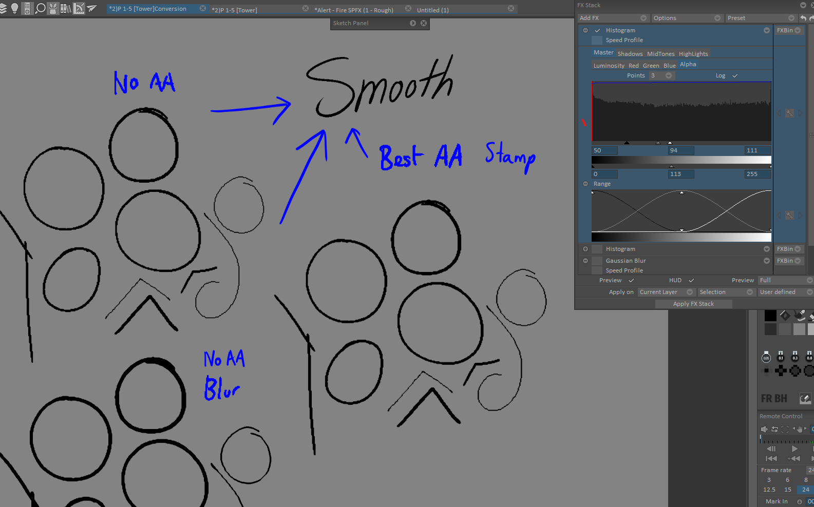

Hello TVP community! I'm trying to achieve nice curves from up-scaling a no-anti-aliasing animation in 1080p to 4K. Now because the lines are pixel-crisp, I'm having to work around this by defaulting my projects in 5K and drawing thicker strokes, later compressing the document down to 4K when the animation is done - smoothing the strokes into believable anti-a clean outlines. This isn't bad and I'm always guaranteed a smooth curve almost all the time, but in terms of memory and PC consumption, it begins to take its toll.
Would anybody happen to know a way to make this work the other direction? I'm in the midst of doing online streaming with animation work and the CPU takes a massive dive when working on a 4K+ document. All of this is manageable offline but when streaming, it's different (1080p docs seem more than fine). Ideally I'd want to keep the anti-aliasing disabled to keep the colouring phase painless and also keep the "Sketch panel" tools from turning messy during cleaning up the animation, if possible.
I've given it some experimenting but the results as you'll see from the attached image are still blocky. What you'll see is a 1080p doodle copied 3 times, each given it's own unique treatment > Modify document to 4K> Play with Histogram FX.

That's interesting that you are upscaling from 1080p to 4K . As a rule I've always been told that working with any sort of pixel art , whether in Photoshop or TVPaint , it is better not to upscale the artwork from 1920 x 1080 to 4K. My own workflow is to start overscale at 3K (3072 x 1728) or 4K (4096 x 2304) resolution, then scale down for final output to 1920 x 1080.

Upscaling any line art is ... problematic. And you will definitely not get a smooth line from that, no matter which trickery you attempt. Depending on your expectations of quality, the better solution might be to get a computer which works with 4K. I started that 2 yrs ago, and it works even on my old machine with 8 GB RAM.
