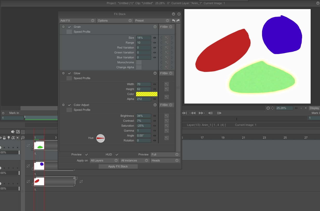

There is an option in the FX Stack to Apply on All Layers. You have to make sure that the FX Stack is set to Apply on All Layers , All Instances . (this is important ... if you don't have All Instances selected, it doesn't work) .
This first screenshot shows how I have three FX -- Color Adjust /Glow /Grain -- applied to one layer , but I've selected to Apply on All Layers /All Instances.

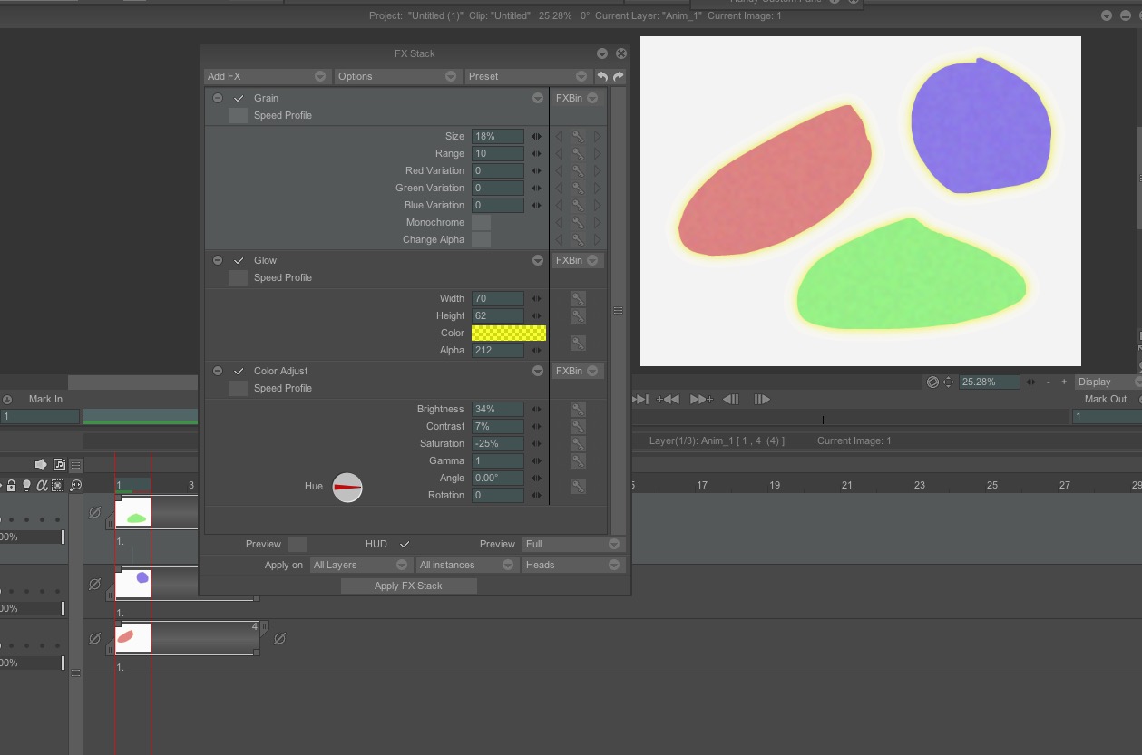

In the second screenshot you can see that the FX , Color Adjust /Glow /Grain , have been applied to each layer.
