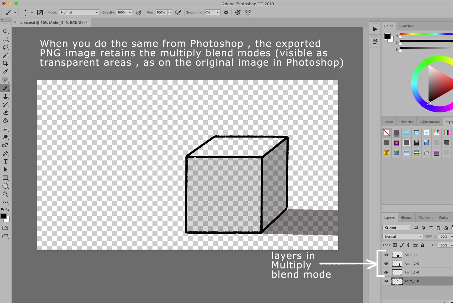

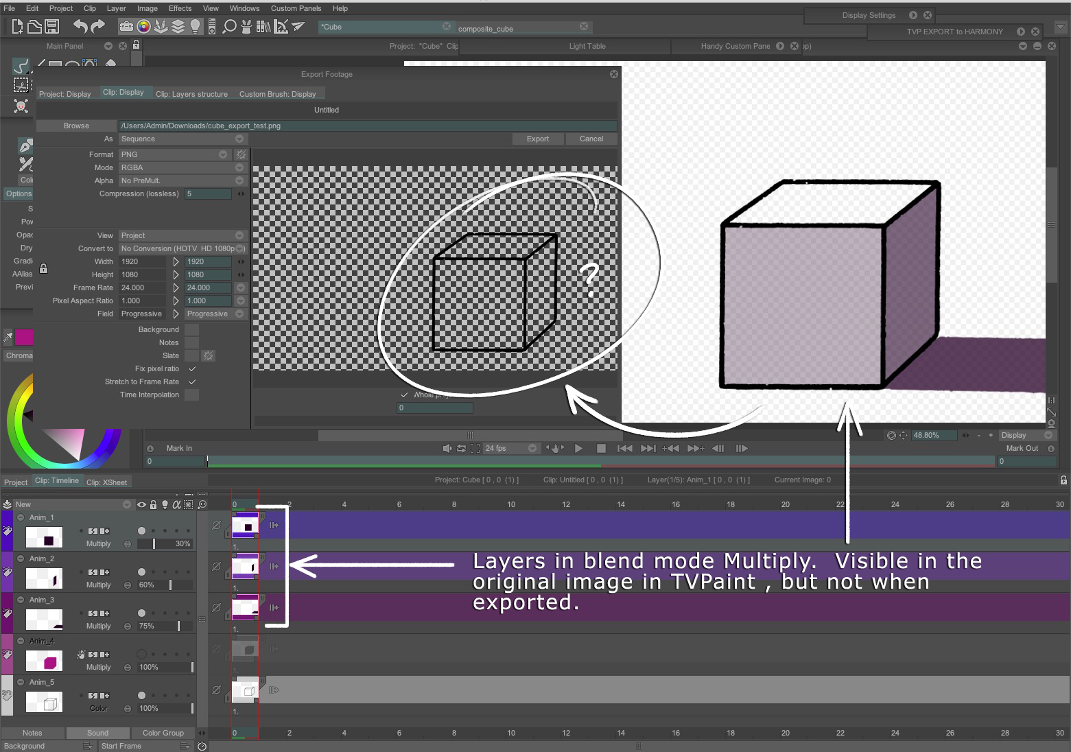

Try this: 3 layers , in blend mode Multiply, with 1 layer (line art) in normal Color blend mode. Export to PNG . The resulting PNG image does not have the multiply layers visible , only the line art.
But try the same thing with identical layer structure and blend modes from Photoshop and you will find that the blend modes (with transparency) are visible on the resulting export from PS.
This was exported from Photoshop , with the result that the transparent layers in Multiply blend mode are visible:
This is the same result exported from TVPaint (where did the Multiply blend mode layers go ?) --

The issue you have mentioned is explained by the fact the Multiply mode does multiply pixel values to get new pixel values, as implied by its name.
Consequently, you can easily guess what would happen if a pixel from a layer set to Multiply mode would see its values multiplied by a non-colored, transparent pixel (of 0, 0, 0, 0 RGBA value): it will also turn into a non-colored, transparent pixel itself.
The confusion usually stems from TVPaint's default display settings which show users a "fake", white background. Preview is all fine in this case, because the "Multiply Layer"'s pixels would be multiplied by white, opaque pixels. But if you choose to export your animation / drawing without this "fake" background (by unchecking the "Background" option in the export panel), you will have effectively multiplied the "Multiply Layer"'s pixels by non-colored, transparent pixels and turned them transparent as well. Thus, in your cube example above, turning the "Background" option on in the export panel would give you the results you want.
Regading the Keyframer, having a regular Animation Layer filled with white would also make the "Multiply" Layers from your Source Project appear. However, you may not want the whole surroundings of your cube to be white, opaque pixels. In this case, what you would have to do is to use the Paint Bucket tool on an Animation Layer to fill the colored spaces on your Layers set to Multiply mode. Still, there is currently an issue with that because the Paint Bucket "Display" Source mode does not take the "fake" background into account, which makes colorizing pixels from Layers set to Multiply mode difficult. This is exactly what we were discussing today. We are now working on adding a "Display (with background)" Source option to the Paint Bucket to solve this issue.
