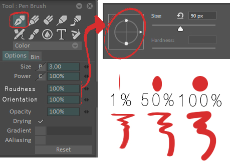

1- the hability to modify Roudness and orientation to the pen brush.
I made a custom anim brush where the anim work as "roudness" been 1 flat and 100 a perfect circle:
Roudness.tvpx
(556.5 KiB) Downloaded 1178 times

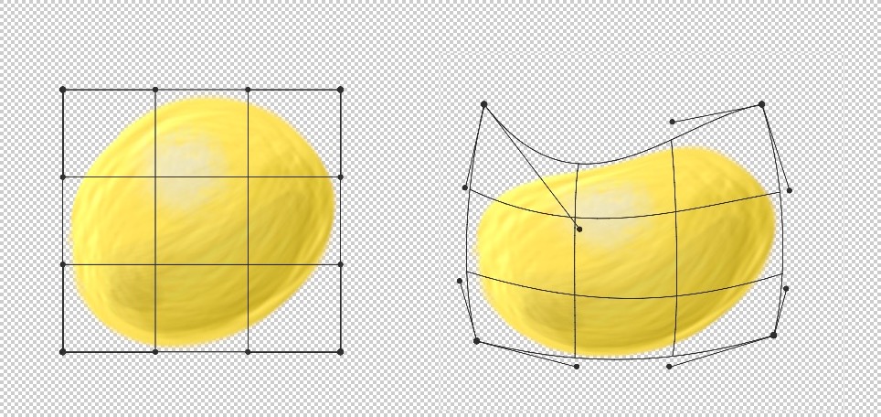

4- it would be amazing if there was some warp tool abaible, i know the profesional version has a warp tool. but i mean the warp tool like the photoshop has. or at least some way to adapt the warp grid fx to the selection, that would be incredibly useful.

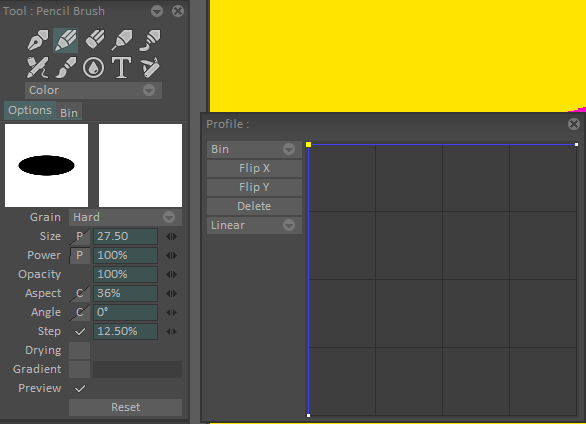

It is possible to work around by adjusting either the pencil or the airbrush:
Re: Some observation about the tools

4- it would be amazing if there was some warp tool available. I know the professional version has a warp tool. but I mean the warp tool like Photoshop has. or at least some way to adapt the warp grid fx to the selection, that would be incredibly useful.
+1 .
To have a warp tool that has controls similar to the warp tool in Photoshop AND can also be Keyframed to animate a progressive warp would be a very welcome addition.

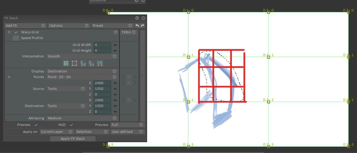

The current Warp tool in TVPaint Pro edition is actually a rather amazing tool (very flexible the way it allows you to bend and distort an image) but unfortunately it is not as useful for animation as it could be because it is unconnected to the FX Stack to be able to add keyframes to control the warp over time from frame to frame.
https://www.tvpaint.com/doc/tvp11/index ... sform-warp
