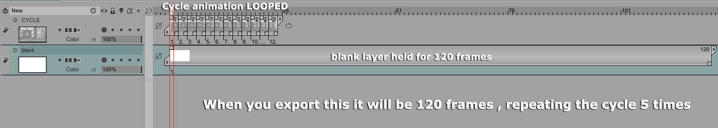

My first thought was the same thing Slowtiger mentioned.
- create another layer and extend it to the frame count you want
Say you have a 12 drawing cycle ON 2's ... so it's a 24 frame cycle . Set it to loop.
Underneath make a new blank Anim layer an stretch it out to 120 frames (24 x 5 = 120)
So when you export this to a .MOV or .AVI it will repeat 5 times.

Adding an empty long layer active, and setting the other layers to loop does indeed work. Nice and quick! Only thing is it won't play nice with a CT layer.
