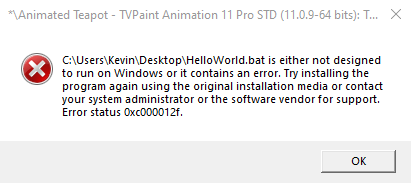

This is my TVPaint George script:
Code: Select all
tv_plugin "C:/Users/Kevin/Desktop/HelloWorld.bat" open
And this is TVPaint's error message when I run it:
"C:/Users/Kevin/Desktop/HelloWorld.bat is either not designed to run on Windows or it contains an error. Try installing the program again using the original installation media or contact your system administrator or the software vendor for support. Error status 0xc000012f"
EDIT: I have looked into this and the only examples I could find were using TVPaint's .dll extension files as plugins. If anyone knows if running a script is possible, please let me know!
