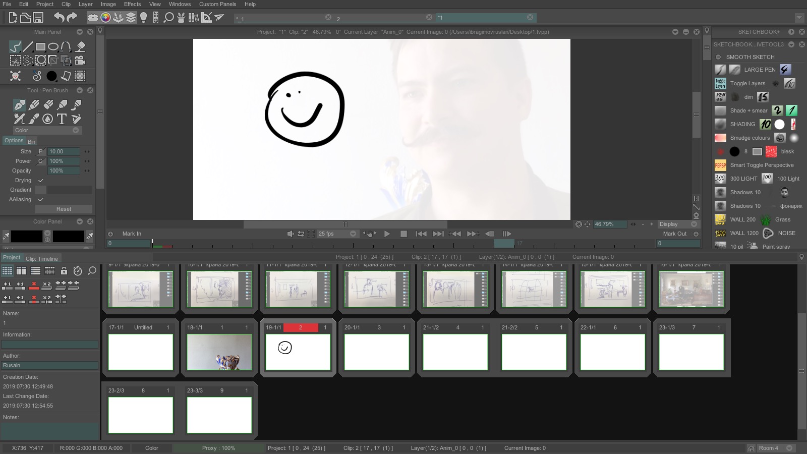

Hey. I make 100 clips as sketches. Then I want to make an accurate drawing on the new layer above. I need to make each layer 50% transparent. Question: Can someone share a soft button to make all layers 50% transparent inside all 100 clips? please, it is very necessary !!!! :cry: :cry: :cry: :cry: :cry: :cry: :cry: :cry: :cry: :cry: :cry: :cry: :cry: :cry: :cry: :cry: :cry: :cry: :cry: :cry: :cry: :cry: :cry: :cry: :cry: :cry: :cry: :cry: :cry: :cry: :cry: :cry: :cry: :cry: :cry: :cry: :cry: :cry: :cry: :roll: :!: :!: :!: :!: :!: :!: :?: :?: :?: :?: :?:

Maybe there is a button to add a new blank layer on top in all clips?

It wasn't very hard, so I made George commands.
Please give it a try.

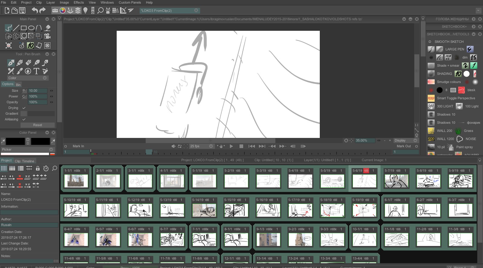

I felt uncomfortable. When I have 200 clips or more, I need to split all the clips into separate scenes with one button. There is no such button. Perplexity.
Help.
Write a script please.
1. With one button, split all the scenes into separate clips. :D
2. With a single button to split into clips only selected scenes. :oops:
3. With one button to collect all the clips in one scene. :)
4. With one button to collect the selected clips in one scene. :lol:
:D Is it possible?
