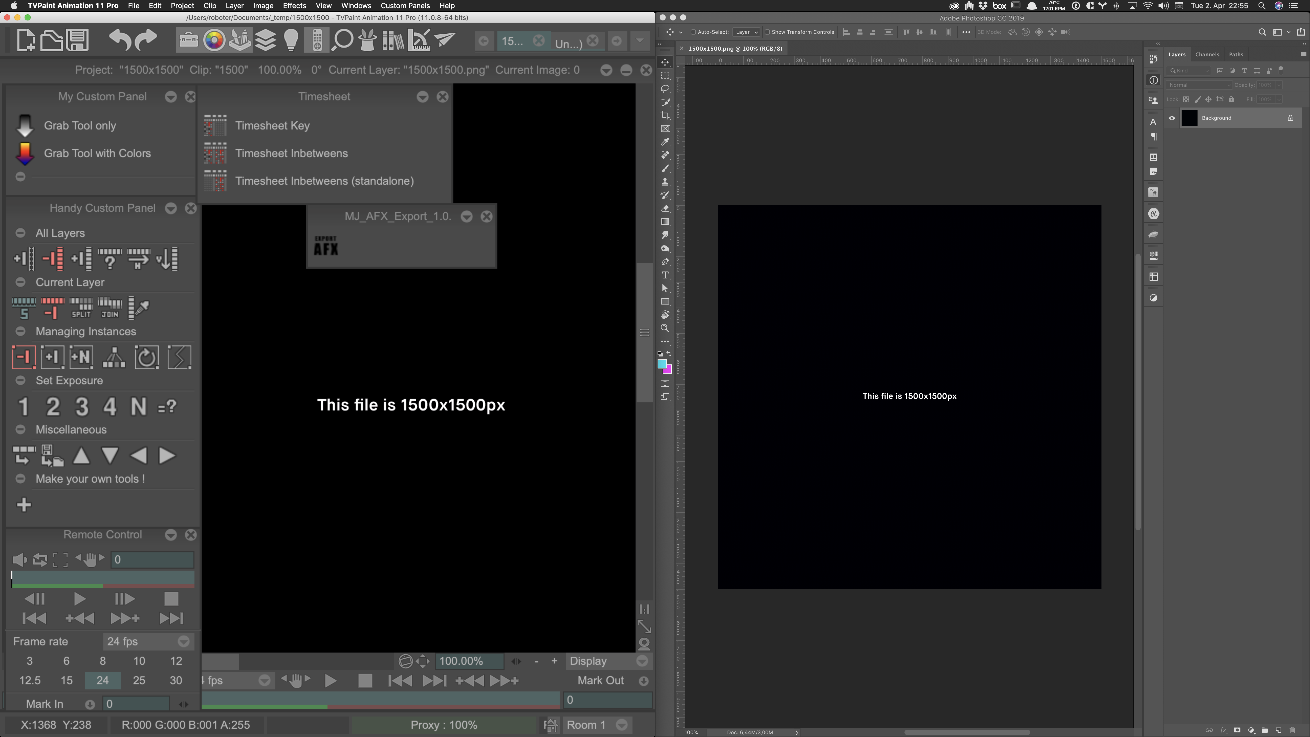

i'm using an imac with the resolution of 5120x2880. I created a screenshot for you with TVP and Photoshop showing the same file at 100% zoom. TV Paint does not use the full resolution instead the whole interface including the file is pixelated. This is not the case when i boot into windows and use the same monitor.

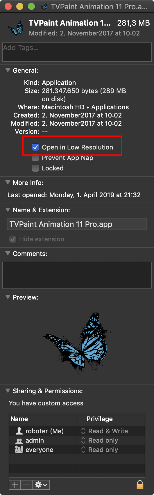

I already tried to tell the OS to run the App in low and hi resolution – no fix. please see the attached screenshots.
Interface pixelation and scaling up file:
Low / high res settings

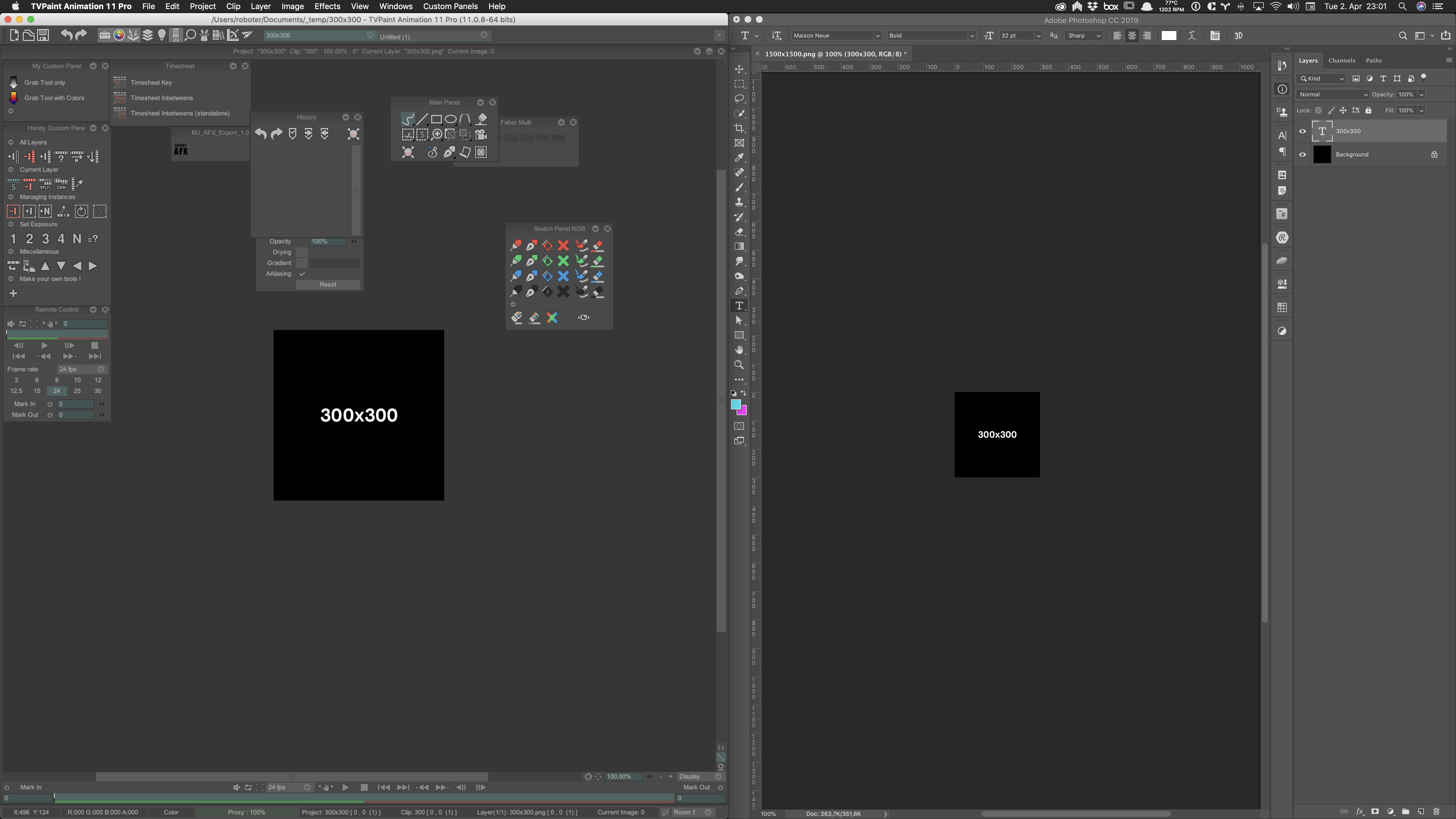

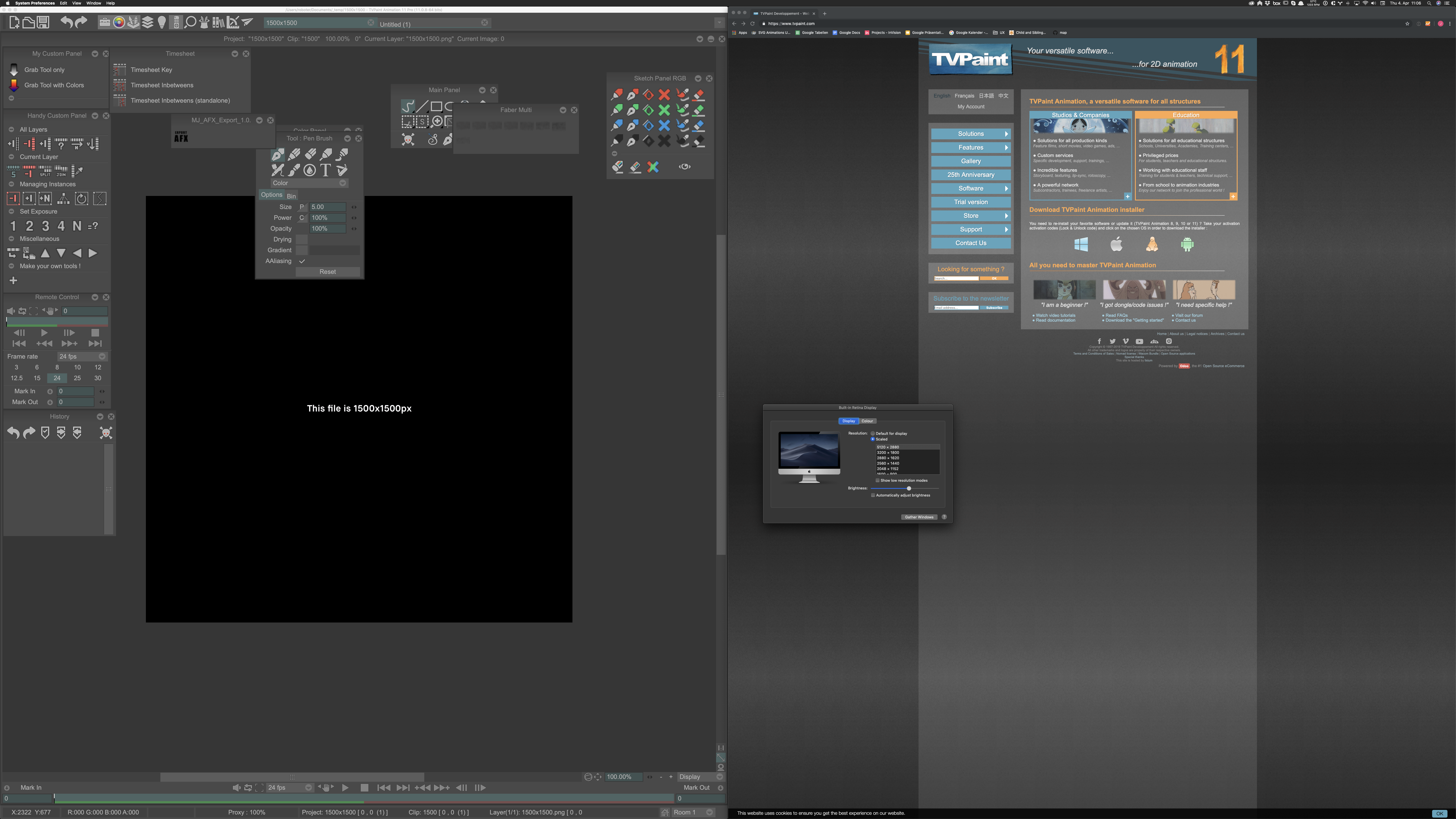

i set the interface scaling to 2 and ran the software in low resolution and in 'not low resolution'. The interface is scaled but that does not help anything. Can you post a screenshot of two apps side by side from your 5k iMac at work?
Best
Johannes

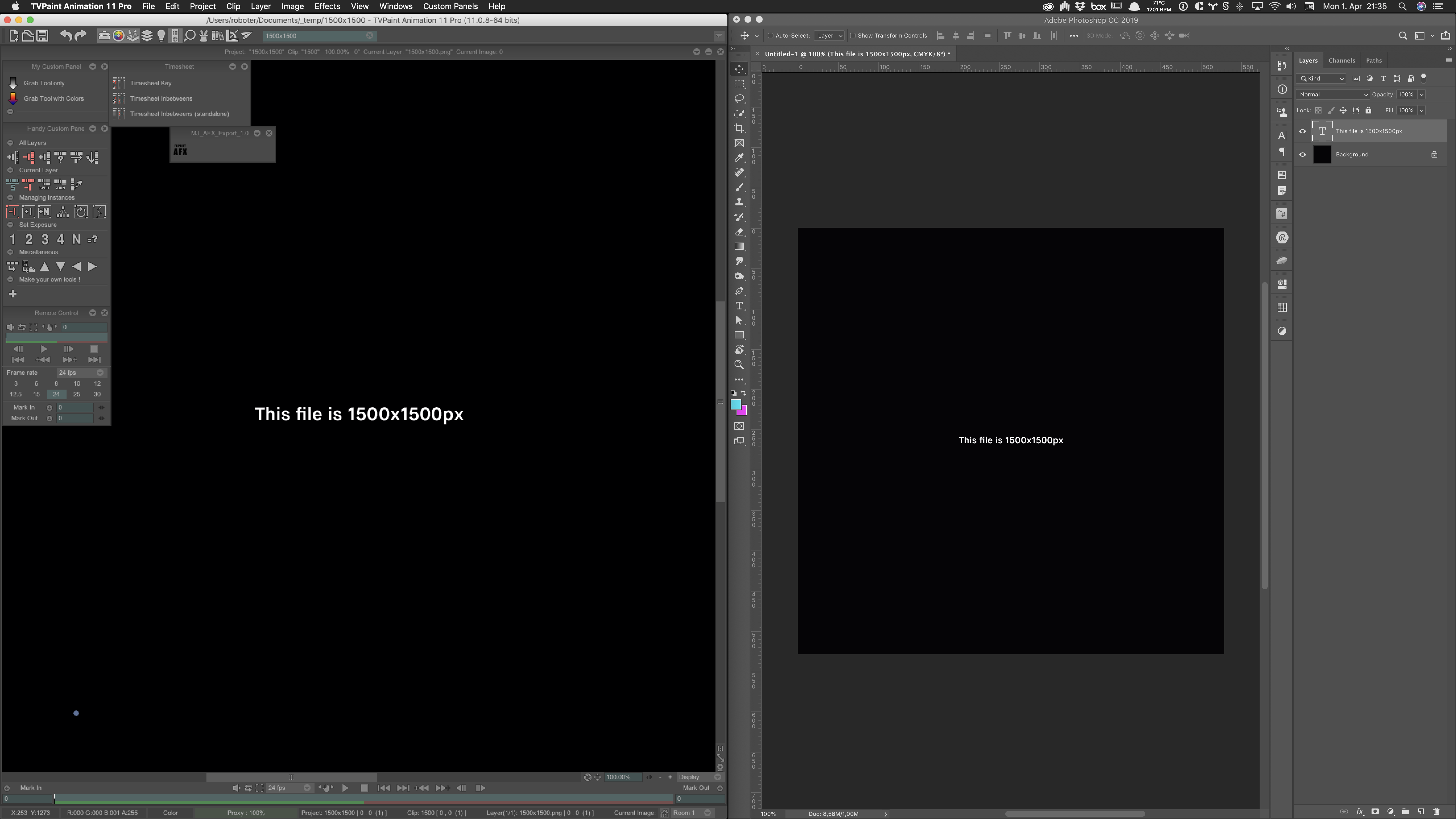

I made another screenshot. Photoshop and TVPAint are at a 100% zoom in Photoshop the file takes up 300x300 'physical' pixels in TVpaint 600x600 so you never get a crisp 100% view which uses the available pixels.

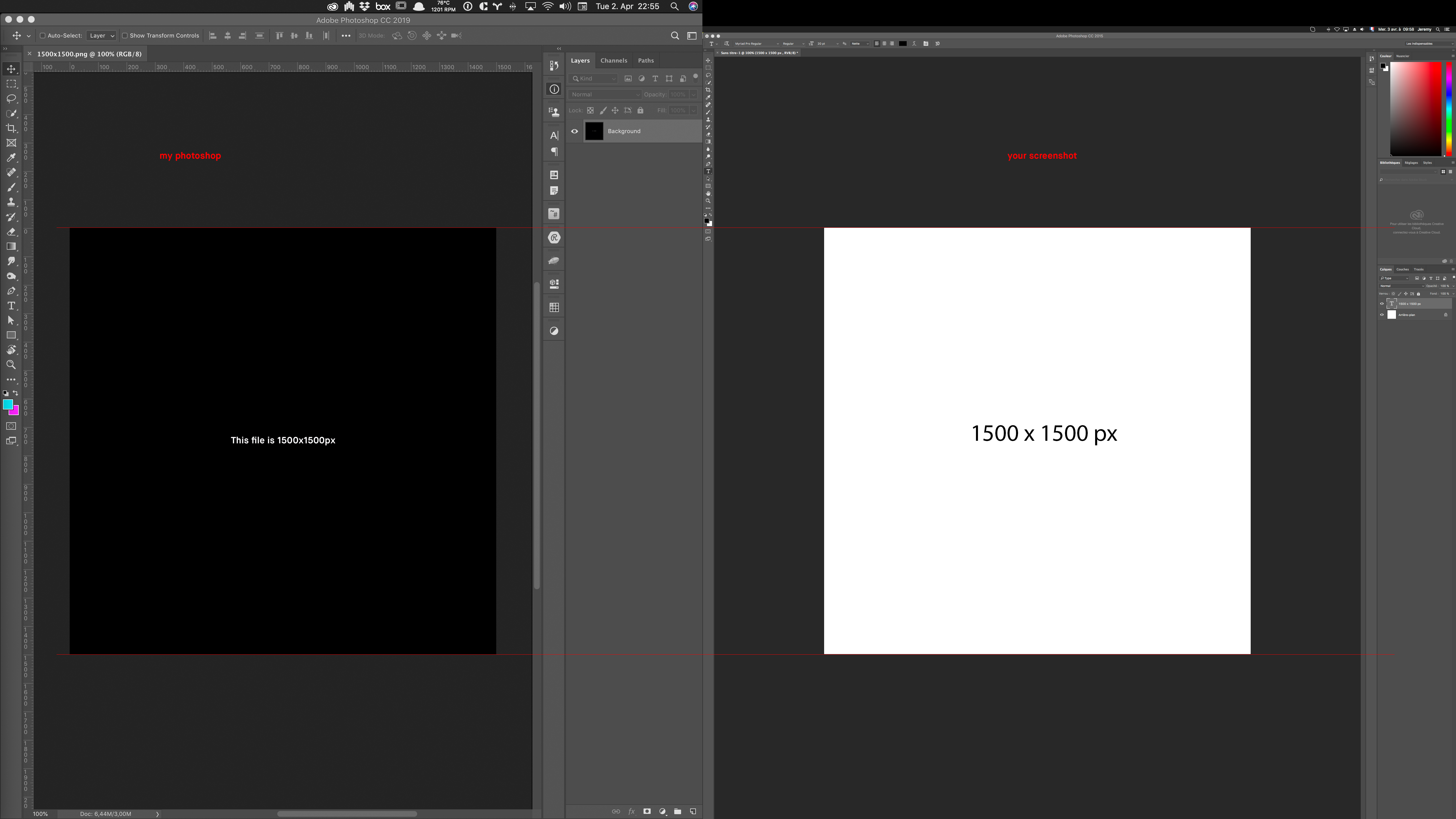

Hi, here is a screenshot of my desktop with TVPaint (interface scale is 1) and photoshop. Each project is 1500x1500 and each zoom factor is 100%.
Strange your 1500x1500 project is "bigger" on your screen than mine.

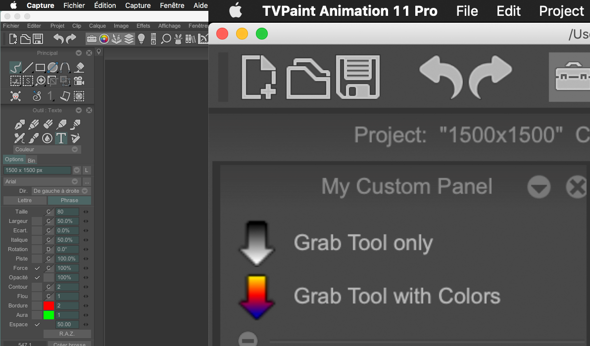

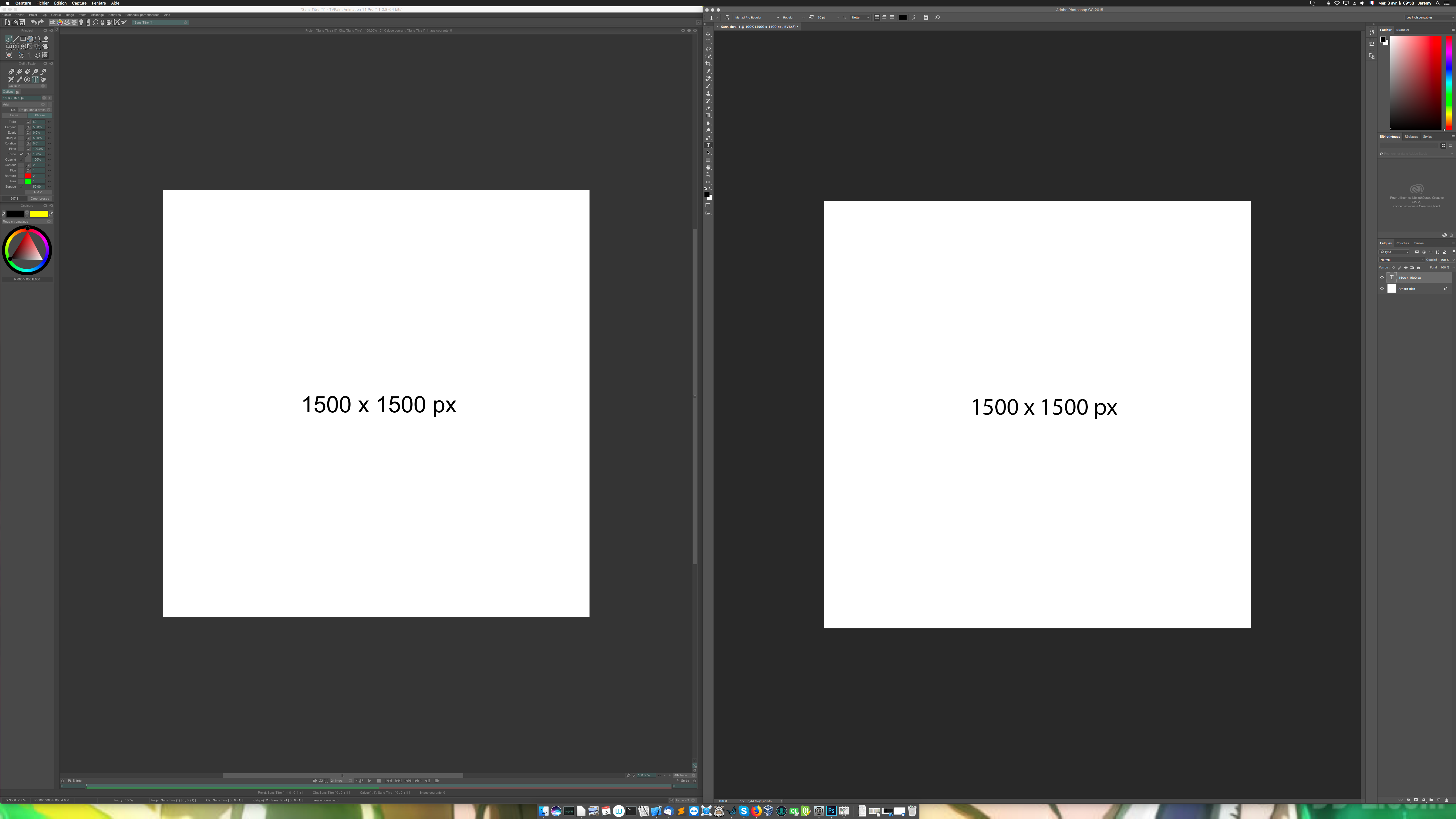

Here is a screenshot of my computer. Photoshop looks so crisp and clear on my computer, much more crisp than JeremyN's screenshot. I don't understand what is going on since we're all using 5k iMacs. TVPaint looks fuzzy compared to my other software.

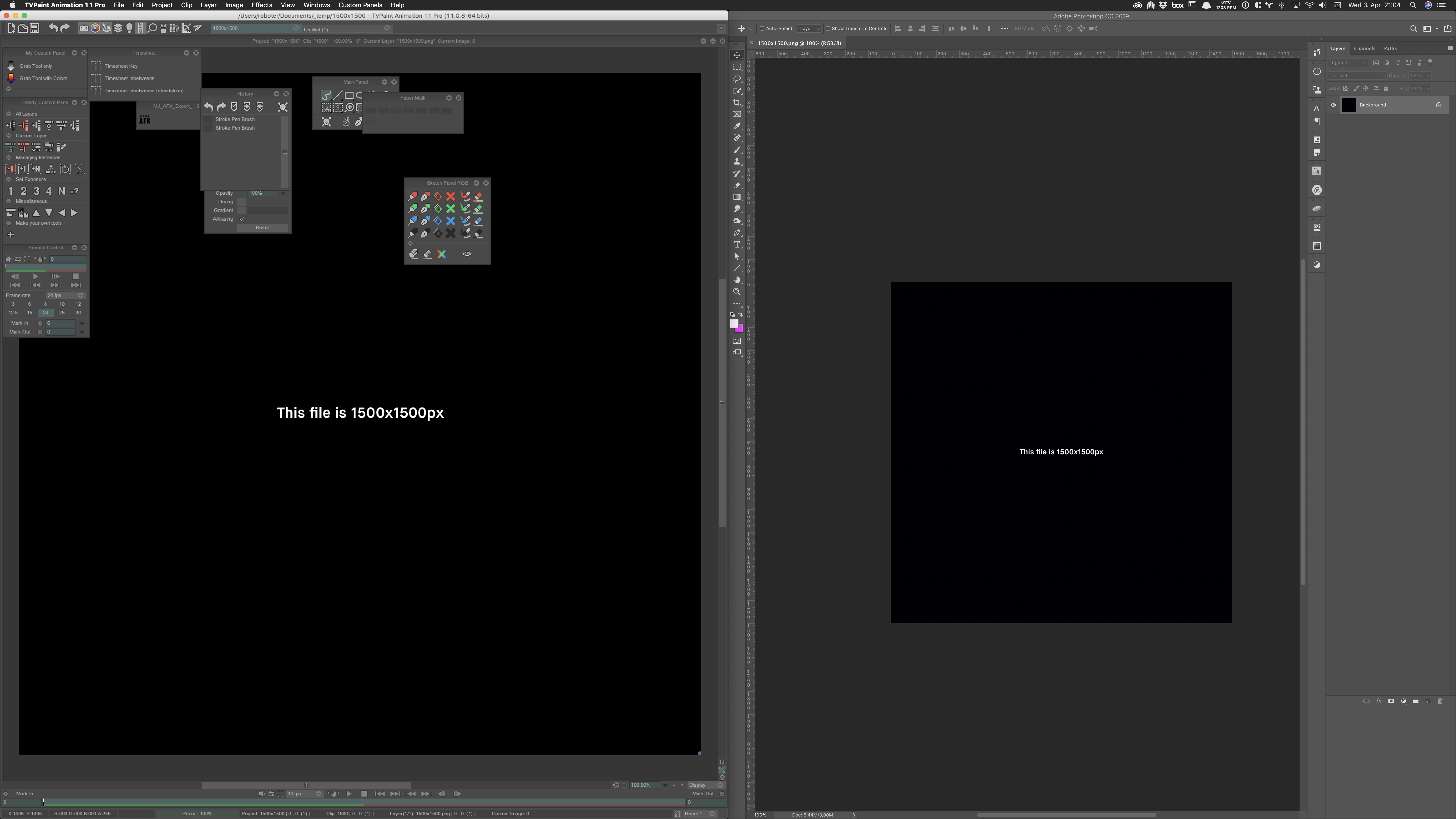

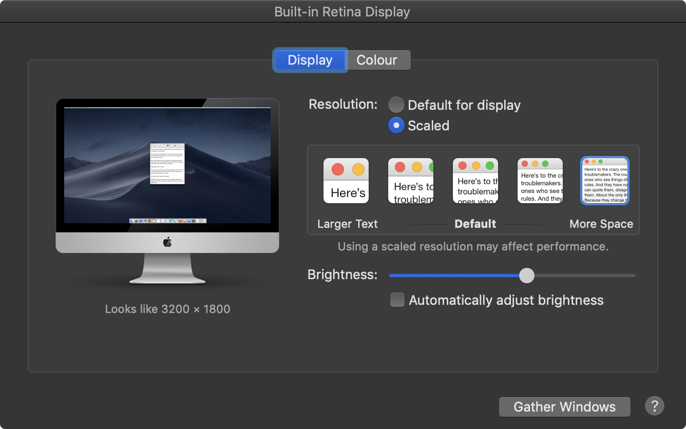

Hi jeremyN, i just noticed that all you interface, even the menu bar is much smaller than my interface, so it seems to be a MacOS setting. But even if i change the scale in system settings i do not get the result you have.
Menu bar compared:
Setting scale to 'More space'
Result:

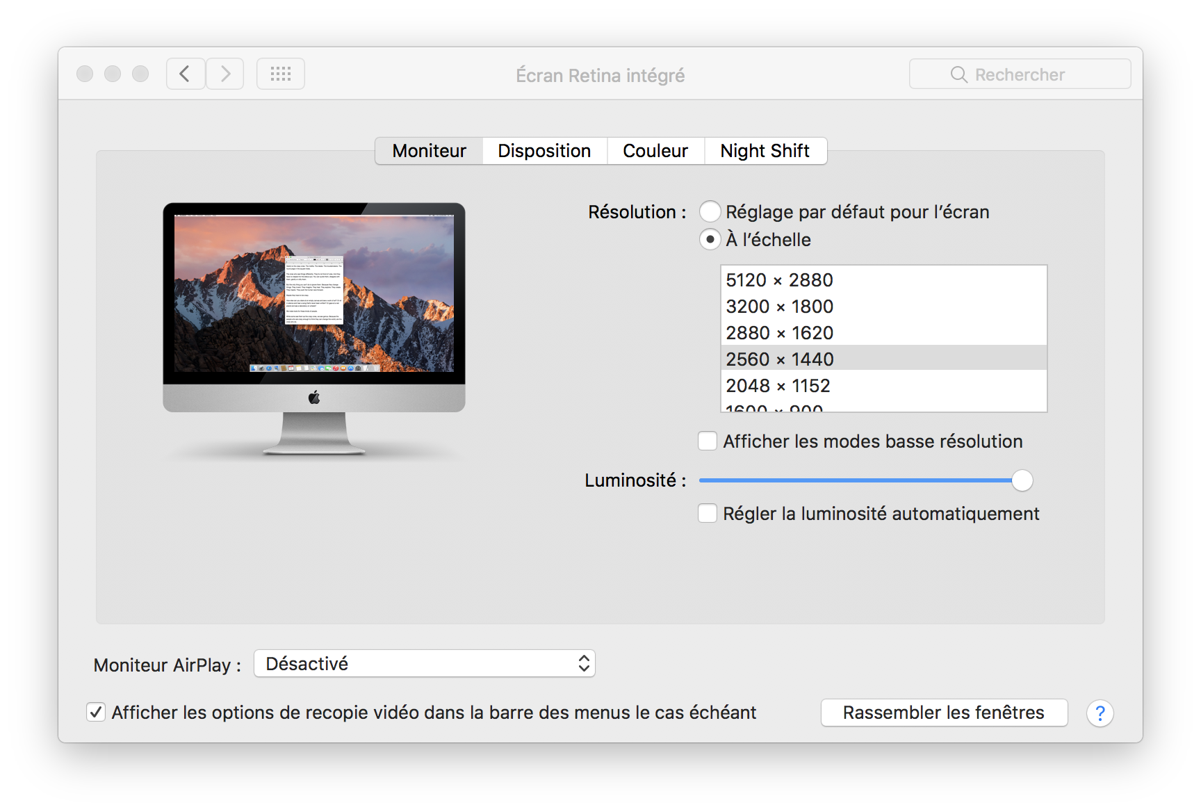

Hi Johannes.
Well, before selecting a setting on this panel:
Press "Alt" then click on scale and you will get this:
Press Alt before selecting "scale"
It's, to my mind, far more convenient (and clear) for selecting a screen definition. For me, Apple settings (like "more space") means nothing so I always use the "default" setting and use the workaround described above to change the screen definition.
Mac Developer

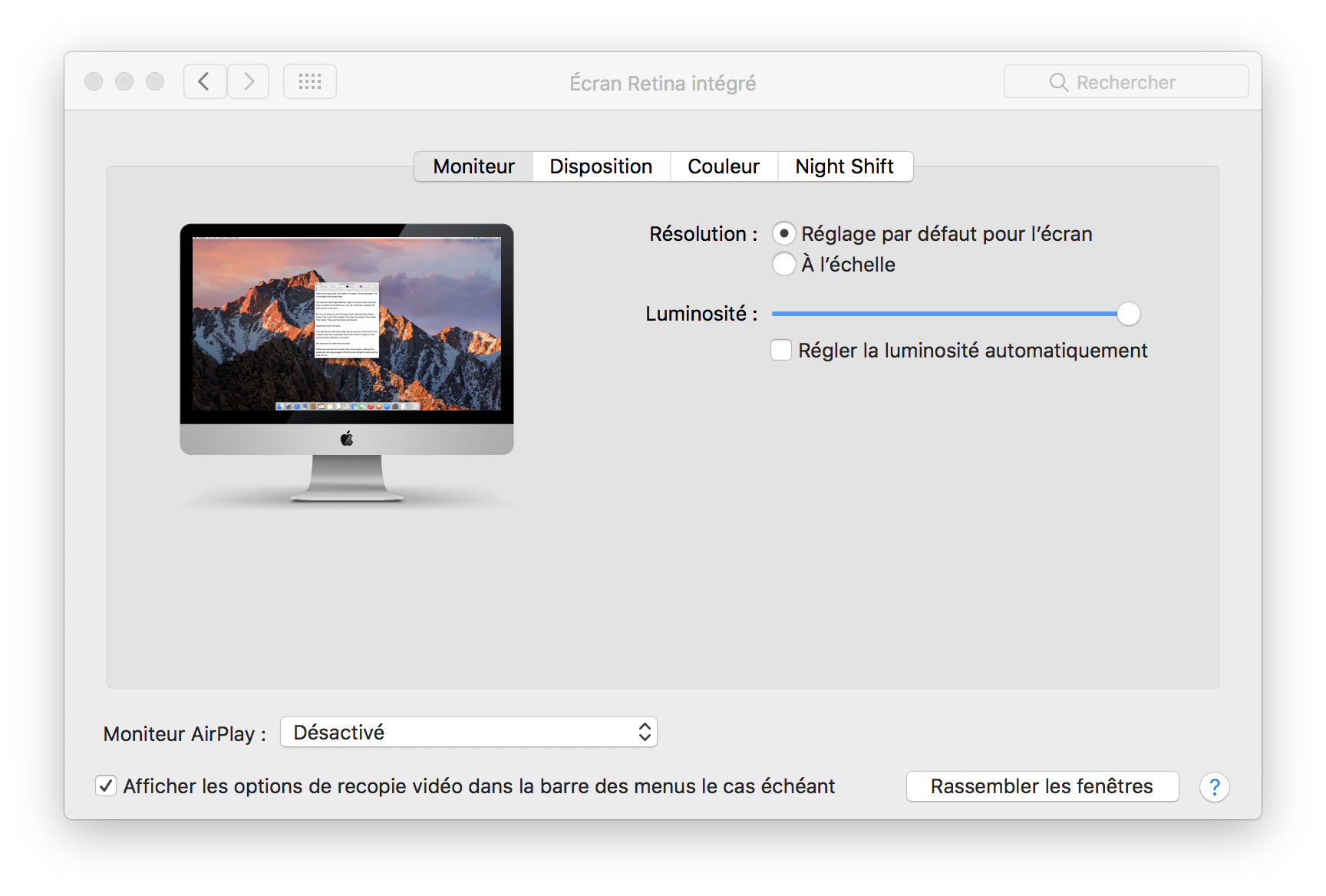

Hi JeremyN,
JeremyN wrote: 04 Apr 2019, 07:41 It's, to my mind, far more convenient (and clear) for selecting a screen definition. For me, Apple settings (like "more space") means nothing so I always use the "default" setting and use the workaround described above to change the screen definition.
This way TVP indeed uses 1:1 pixel. But this settings make every other app and the OS a pain in the a**** to use. So i'd rephrase my question: Will there be an update to use 1:1 pixel like for example photoshop or most apps besides TVP? It would be okay for me if just TVP is using this tiny interface but when everything is that tiny i get headaches very quickly:
