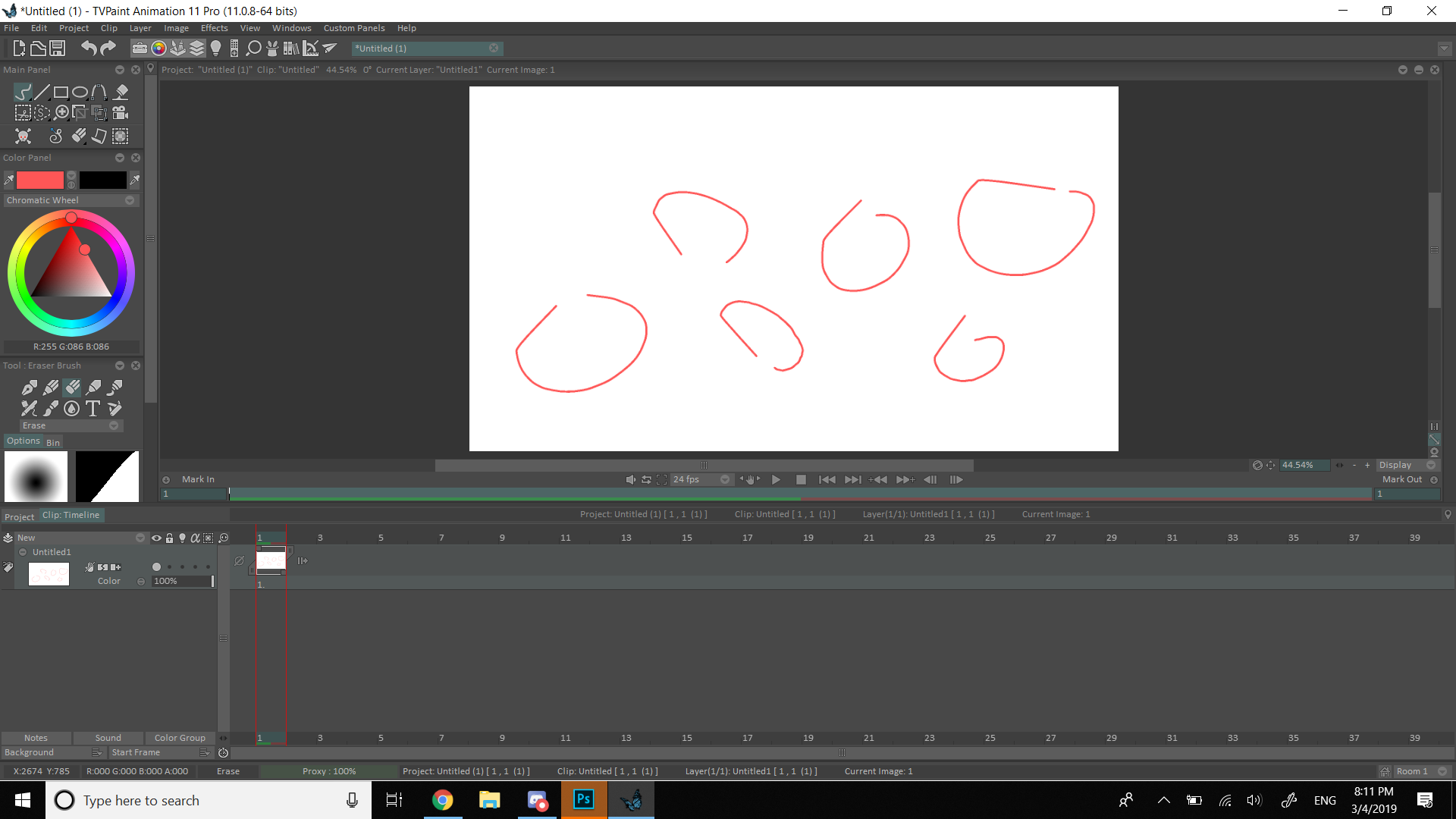

I've tried following the suggestions of every other post addressing this same issue and nothing's worked. Partly because I am a Huion user rather than a Wacom user and Huion's tablet settings are incredibly limited. I also use windows as my operating system. If anyone knows a fix to this I'd really appreciate the help, thank you. I'll attach an image down below.

Hello BellaLemieux,
Did you try switching Tablet modes (Wintab/Windows Ink) and enabling/disabling the subpixel option?

Dean wrote: 05 Mar 2019, 10:16 Hello BellaLemieux,
This fixed it, thank you so much!
