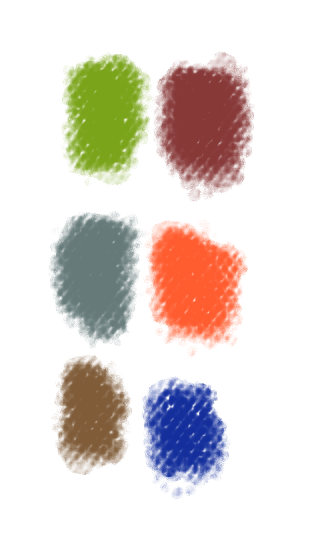

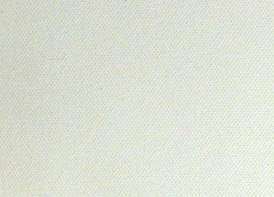

With the help of some friend I found the material in question is called "Baumwolle grundiert mittelgrob", so it's cotton prepared for painting. Some online search dug up this:
I prepared this and got this version:
Export as DEEP, put into paper folder, restart TVP, use as paper with hardness 100, size 200%, invert:TVP 10.0.18 and 11.0 MacPro Quadcore 3GHz 16GB OS 10.6.8 Quicktime 7.6.6
