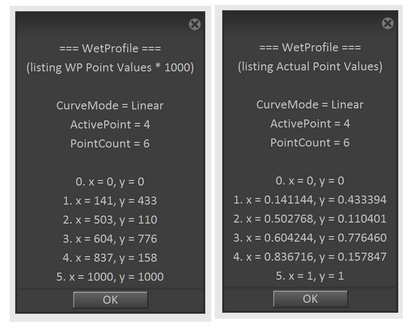

Posts: 1579
Re: Suggestion: More Accurate Wet Profile and Other Profiles when Tweaking
Some version of this points editor interface might do the trick, but 30 points could take a while :D
WetProfile points editor.png (54.99 KiB) Viewed 21272 times
Other GEORGE script variations would permit precise editing of curve points (CSize, CJitter, CAngle, CShift, CSmear).
A similar points editor option for the FX Speed Profile would be useful, as well...
