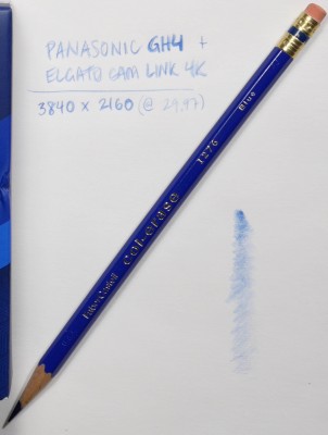

Thanks, David, for alerting us to the SparkoCam software. I bought it and used it to teach for the better part of a semester, and then started to explore some options for higher image quality into TVPaint. I've found a way to approach DSLR image quality with the live feed, and 3840x2160 capture.
It requires a camera that can produce a 4k HDMI out (I am using the Panasonic GH4), and the Elgato Cam Link 4k, which is about $120. Elgato has a list of cameras that can produce the 4k HDMI output here: https://www.elgato.com/en/gaming/cam-link/camera-check
The 4K live feed is obviously CPU intensive. I've uploaded an image gallery showing a screengrab of the Video In settings, and also an export of the 3840x2160 captured image: https://ibb.co/album/MZsgYT
I'm attaching a cropped JPG of the actual capture, to show a general idea of the image fidelity:
Hope this information is useful!
-David

meslin wrote: 15 Nov 2020, 08:08 Thanks, David, for alerting us to the SparkoCam software. I bought it and used it to teach for the better part of a semester, and then started to explore some options for higher image quality into TVPaint. I've found a way to approach DSLR image quality with the live feed, and 3840x2160 capture.
-David
This is very useful. Thank you. The school where I was teaching at previously standardized all the stop-motion classes to only use Dragonframe , but this is good to know for those of us who still want to use Video Capture in TVPaint for traditional animation techniques , such as stop motion puppet animation or other under-the-camera object animation, or even for capturing hand-drawn animation on paper.
