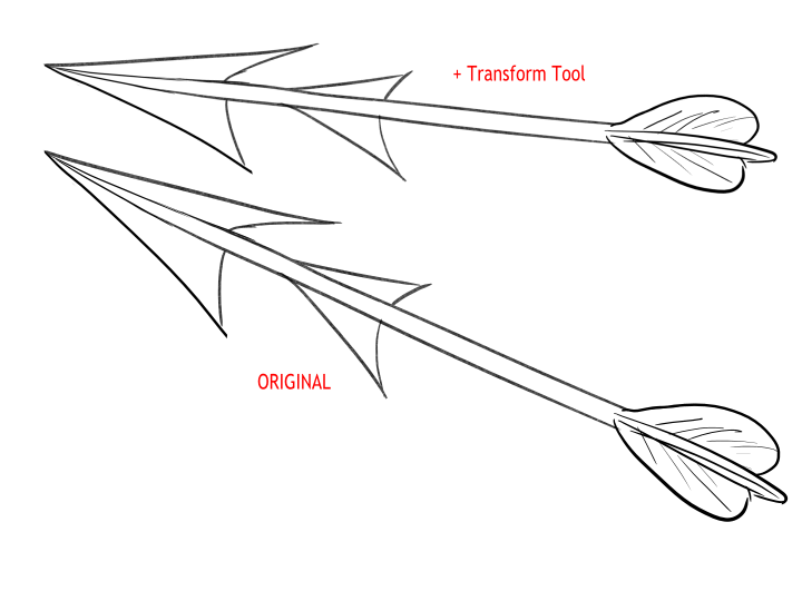

well, just to mention a workaround, to get back some lost sharpness on the line layer in your workflow :
after your "Cut-To-Layer, then use the transform tool to enlarge or rotate" action,
and before your "merge back to the original layer", you could apply
a "Sharpness Recovering" FX, which is in fact an Alpha Curve, (see pict.)
ps: this tip works fine on line layers only, not on final colored/merged drawings.

- addsharpness.png (90.09 KiB) Viewed 36871 times

Thank you, ZigOtto. I will try this. I appreciate your help.
