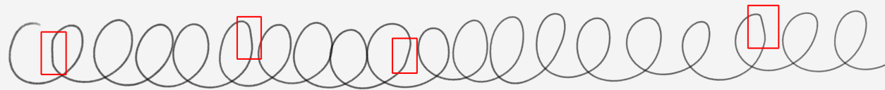

Hi, I'm currently on TVP 11 version 11.0.8-64 bits, on Mac OS X Sierra 10.12.6, Wacom driver 6.3.29-6, on the Cintiq 22HD.
Drawing curves produces a sudden straight line in the drawing as shown below:
Screen Shot 2018-04-29 at 9.49.26 PM.png (42.81 KiB) Viewed 20510 times
Is there any way to fix this?

i am now on linux:
i have the same isue.
fast drawing bug.png (69.16 KiB) Viewed 20485 times
it seems to be unrelated to brush size or complexity.
the effect is the same with a large custombrush as with the standard pentool

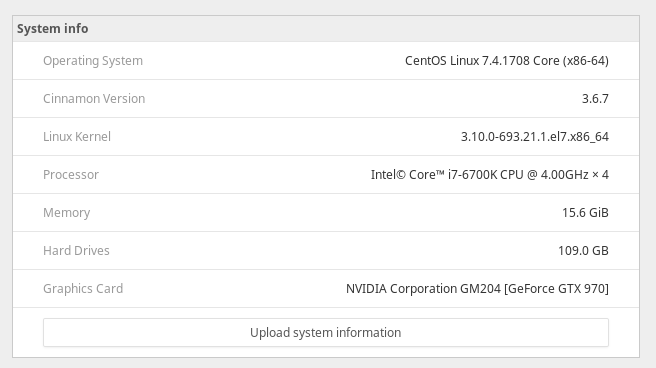

Posts: 4519
Re: Strokes will create straight line suddenly
on this machine: no problems, even when circling very fast with a heavy brush. no straight lines show up.
