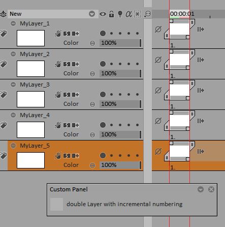

I know, it's another thing, but it was inspired by this discussion.
It's my first george-script ever and it just covers the base idea of numbering layers. It works fine for my personal use, but it has some limitations. You get an error message, if the last letter of the layers name is not a number. And it will only increase the last number of the name, so after number 19 you'll get 110, 111, ....
Parts of the script are taken from this posting: http://forum.tvpaint.com/viewtopic.php?f=34&t=10294
How to use:
1. The script just gives new layer names. The duplicating of a layer is done by (Key:Layer:Duplicate Instances)
2. The layers name has to have a number as the last letter
DoubleLayerPlusNumber.tvpx
(5.5 KiB) Downloaded 1476 times

Thanks, Animark.
That will help for now, though I'd much rather see the bugs in the Layer Management Panel fixed without the addition of yet another custom panel. These things have a tendency of multiplying faster than vermin.
