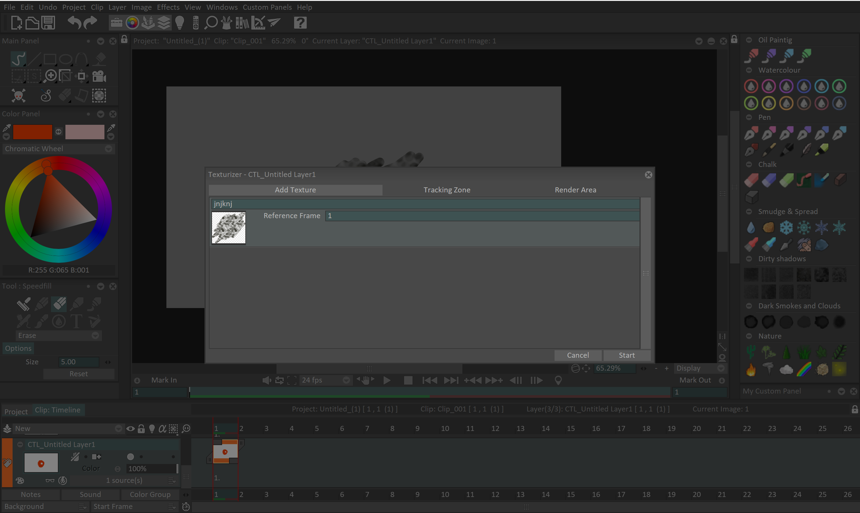

I just watched the tutorial about "Texturizer in CTG" But I can't find the "Select Color" button for Tracking Zone and Render Area.
Can anybody help PLZ.
Posts: 1126
Re: Texturizer question
Hello, you need to extend the Texturizer window from the right side to make the button appear, this is a visual bug which can occur on certain screen sizes with a scaling setting above 1.

Dean wrote: 30 Jan 2023, 08:18 Hello, you need to extend the Texturizer window from the right side to make the button appear, this is a visual bug which can occur on certain screen sizes with a scaling setting above 1.

It worked. Thank you.
