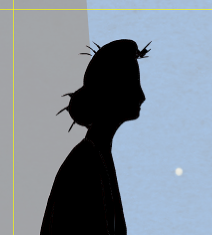

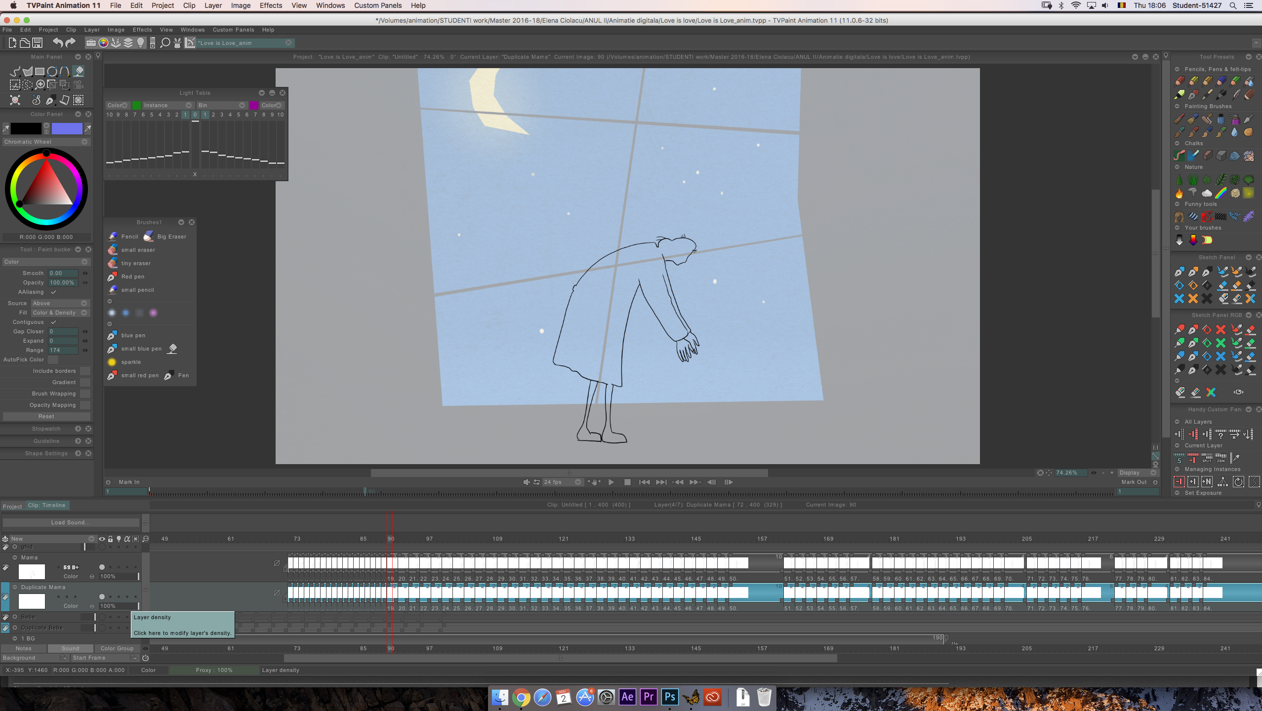

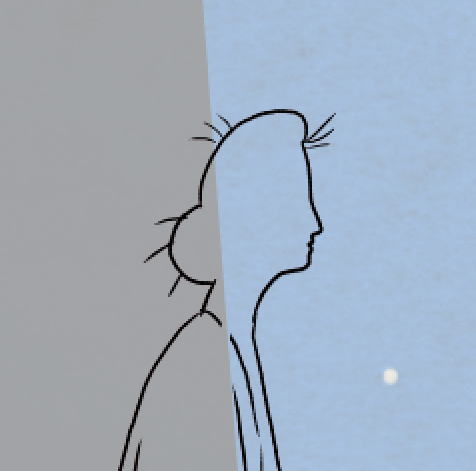

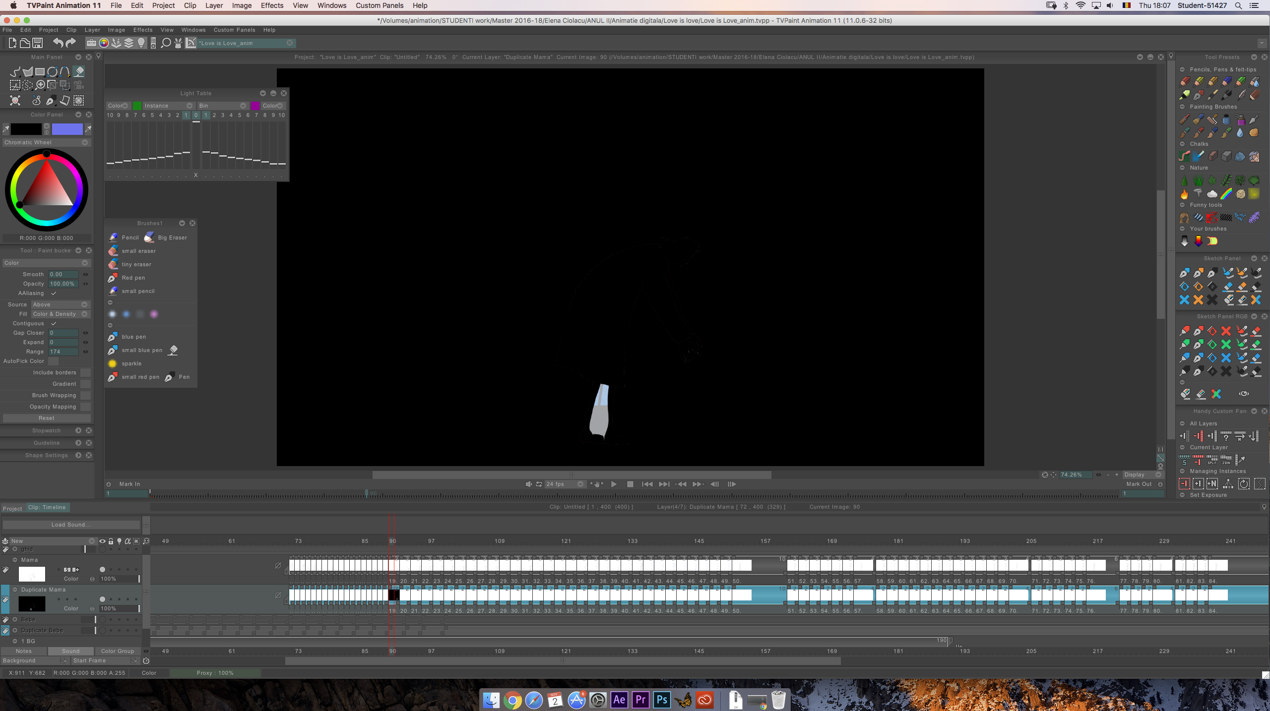

I am trying to color an animation and I have followed exactly the steps shown in your tutorial. However the bucket tool does not fill inside my character but outside of it. What am I doing wrong?
Also:
I've tried using the rectangle fill tool and although it does the job, it thickens the lines that are not meant to be shape contour (like the hairs of my character). Please look at the attached images to see what I mean.
This is so frustrating :( I would really appreciate your help!
P.S. I just noticed that the bucket stops working properly after I switch to a different tool and come back.

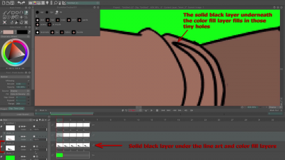

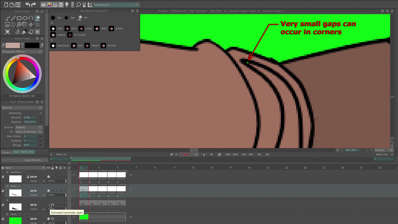

Around the 5:51 mark [ https://youtu.be/Y5GBwEE6jgE?t=351 ] he explains how he uses the solid black silhouette layer . This is turned on to fill in any tiny gaps where color has not filled in all the way to the line , such as tight corners where two lines intersect , which is typically where gaps or holes will appear. The solid black layer underneath fills in those very small holes to make them the same color as the line art , which in this case is black, but if the line art was grey or red or some other color , the solid silhouette layer would be the same color as the line.
