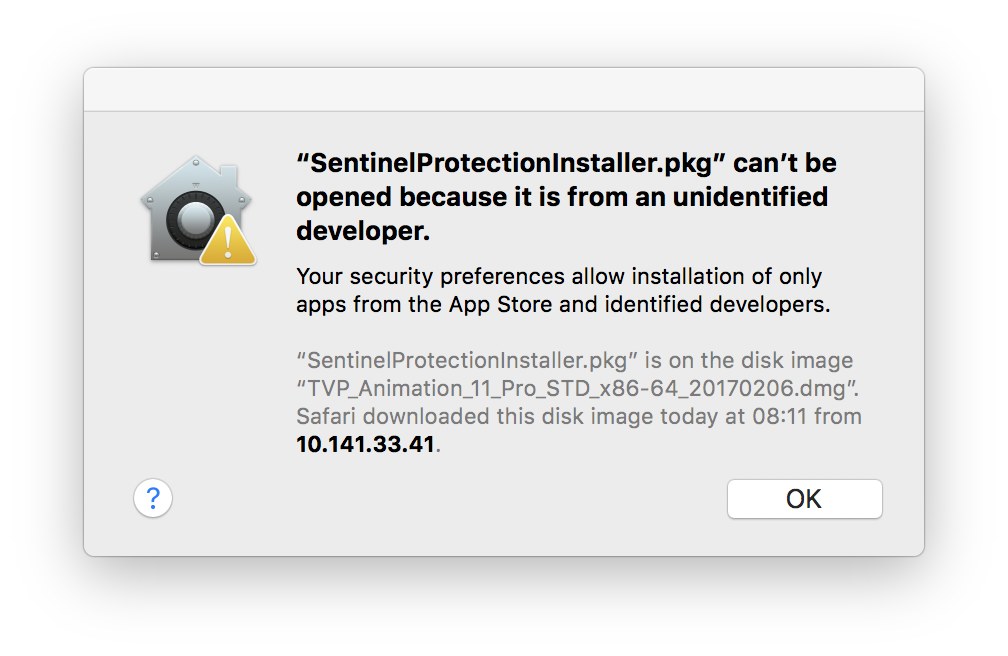

MacOS will tell you that this installer come from an unidentified developer and will not launch it.
First error message
First error message

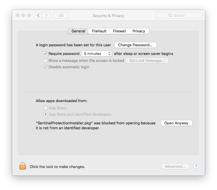

You have to open the System Preference and select "Security and Privacy".
System Preference
System Preference
Click on the lock at the bottom left corner to do some modifications in this window. As you can see, there is white button "Open Anyway" which is displayed, click on it.
Security and privacy

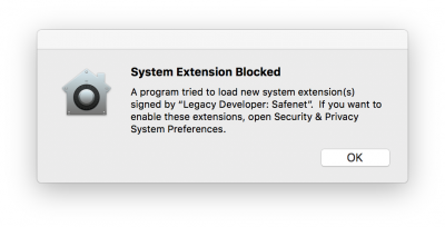

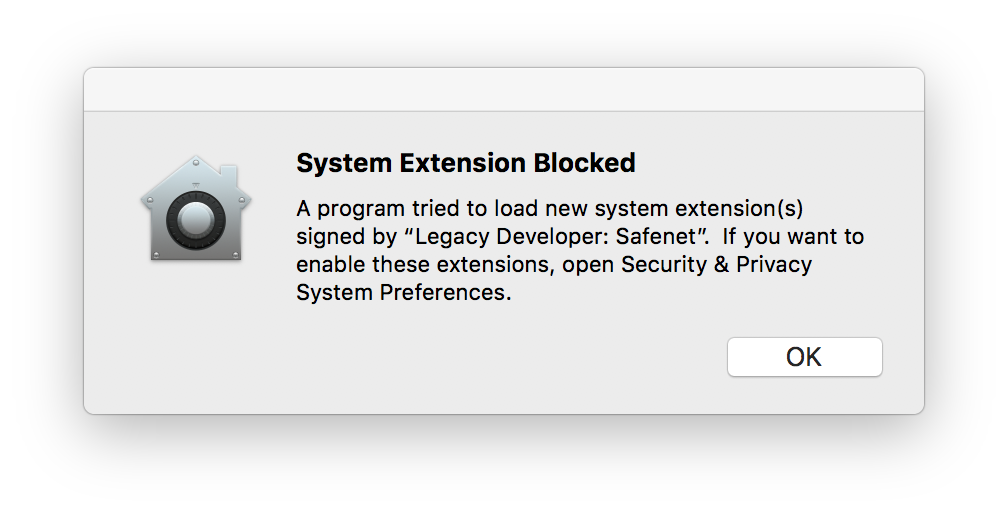

The OS will launch the driver installation, follow what the installation program says until this window appears:
Sentinel blocked
Sentinel blocked

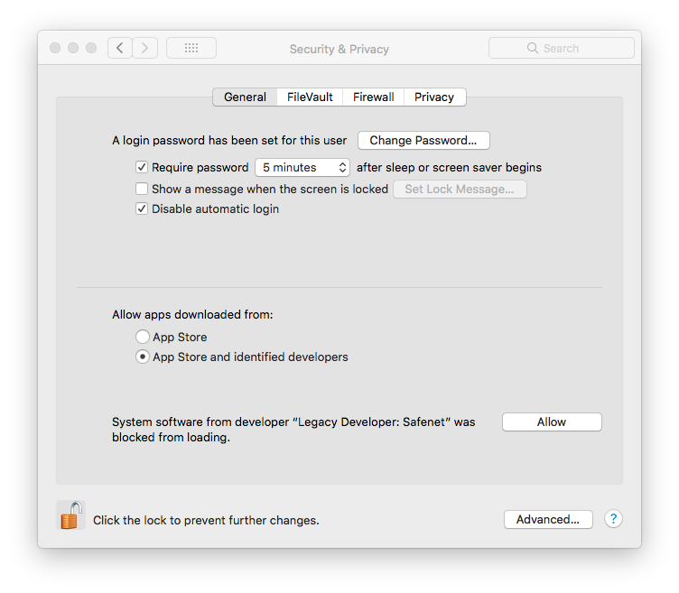

MacOS blocks Sentinel Driver, you have to allow it, returns into the System Preference in "Security and Privacy", a white button "Allow" should have appeared (if not, leave System Preference and re-open them)
Allow Sentinel
Allow Sentinel
Click on "Allow", now Sentinel driver should be ready.

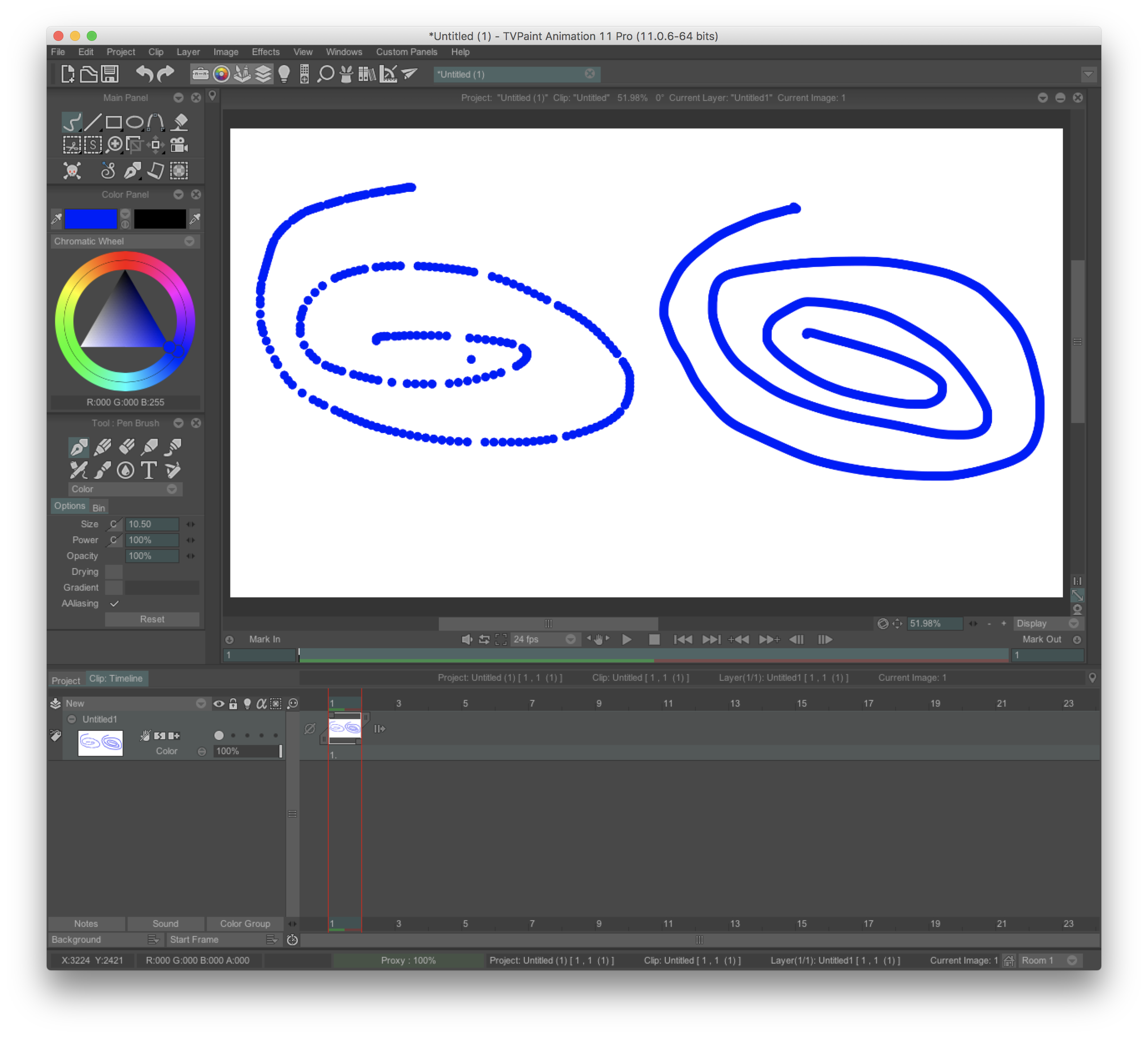

I install lastest Wacom driver ( 6.3.25-2, released the 11th October) and I get sharp splines on TVPaint 64bits
Sharp spline
Sharp spline
But, on the other hand, there is no problem with TVPaint 32bits
Nice spline
Nice spline
So I advised to not upgrade to High Sierra for the moment, at least until Wacom/Apple fix this.
