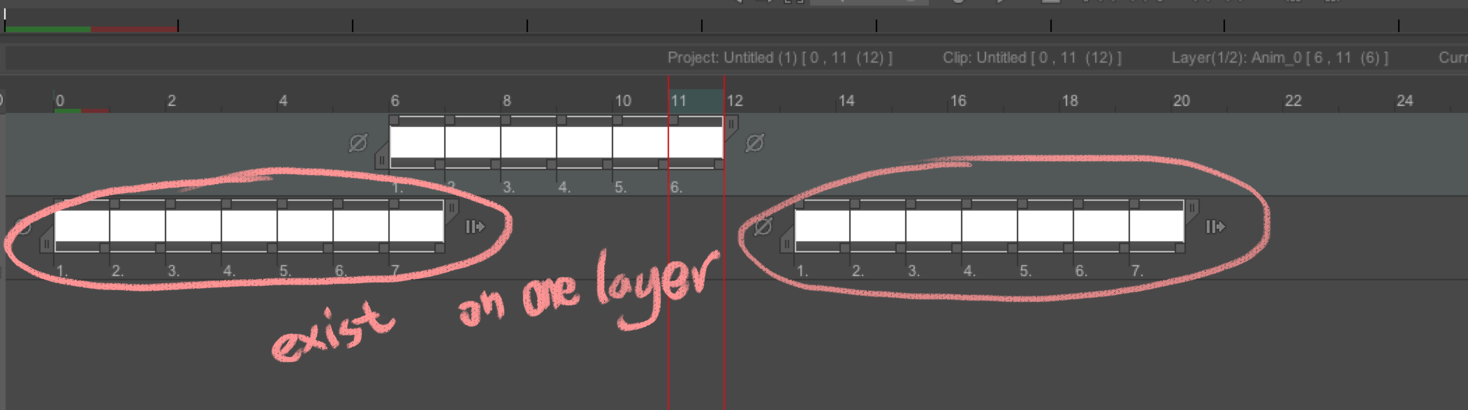

time line improment
Post by yuanqing »
why tvpaint11 cant do this ?
this would help a lot when we dont use circulatory frame
Re: time line improment
Nope, but it's in the to do list for someday.
I just have an empty keyframe there, stretched as long as I need it.
(But it would be nice if TVP could detect a completely empty frame and colour-code it ...)
It's already the case :)
