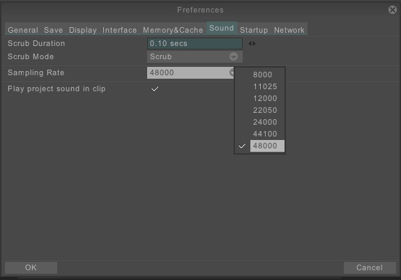

Now, I realize you're talking about importing a .mov file into TVPaint , so I tested it just now using a 2.8 GB .mov file (with sound) . It plays ok for me in TVPaint , the sound seems to be in sync. The codec on my imported movie is Apple ProRes 4444 , with the sound encoding as AAC Stereo , sampling rate 48000 kHz .
Here's something to consider: what is the sampling rate on your .mov file you are attempting to import into TVPaint ? Typically the sound sampling rate will be either 41000 kHz or 48000 kHz . (check in Quicktime : Movie Inspector , to see what the codec and sound sampling rate is) .
IMPORTANT: be sure that your sound sampling rate in TVPaint Preferences is set to the same sound sampling rate as your .mov file or the playback may be off. For example if your TVPaint Prefs are set to sound sampling rate of 48000 kHz , but your .mov file is set to 41000 kHz , it might cause the sound to play out of sync. Change the sampling rate in TVPaint Prefs to match the sampling rate of your .mov file .
TVPaint Sound Prefs_Sampling Rate.jpg (25.55 KiB) Viewed 37939 times
Also, you have to change your configuration of Audio MIDI Setup.app (in Utilities) to match the correct sampling rate (either 41000 kHz or 48000 kHz or whatever sound ampling rate you have in your .mov file) .
