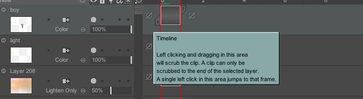

When I import my PSD layers file to TVPaint, the toggle auto break instance icon is missing in TVPaint layers. My way around it is to copy and paste to a new TVpaint layer to activate the auto break instance again. I wonder if this how it suppose to work or is there a way I save and prepare my photoshop file?

Psd layers are imported as "image layer" instead of "anim layer". Image layer are like the ancestors of anim layer and when anim layers have been created, you could turn an image layer into an anim layer with a right right > " Make anim".

Elodie wrote: 09 Aug 2017, 05:43 Psd layers are imported as "image layer" instead of "anim layer". Image layer are like the ancestors of anim layer and when anim layers have been created, you could turn an image layer into an anim layer with a right right > " Make anim".
I cannot make screenshots, so if someone could illustrate my tip, that would be very nice :)
Just in case anyone else is wondering how , here is a screen shot -
Unfortunately , this still doesn't completely solve lam's issue, because it converts the PSD layers to Anim layers, but
with no Auto-Break Instance option . This will wait until the next update to 11.0.7 , when PSD layers will automatically be imported
as Anim layers (with Auto-Break instance) .

It's just a refresh bug.
After having converting to an anim layer, just collapse/uncollapse the layer and the auto-break option will appear

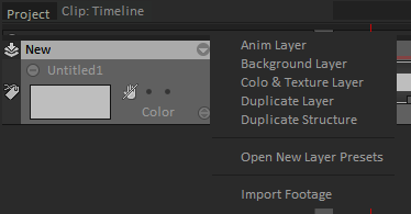

I see what you mean, but you can do that now if you turn off "auto break instance" and "auto create frame" for that specific layer.
Or perhap adding an extra option to the New Layer pull down menu called Reference Layer where both options are turned off by default?
Posts: 2972
Re: Missing auto break instance with PSD file in TVPaint
Well, your last sentence makes no sense since that exactly defines the image layer ... *g*
(oh, and it's called background layer now? That makes sense in terms of ease of understanding.)
Also I guess it's quite some work to code a conversion of old projects so that image layers are opened as animlayers without autobreak, but saved as image layers again to stay compatible to older TVP versions.
